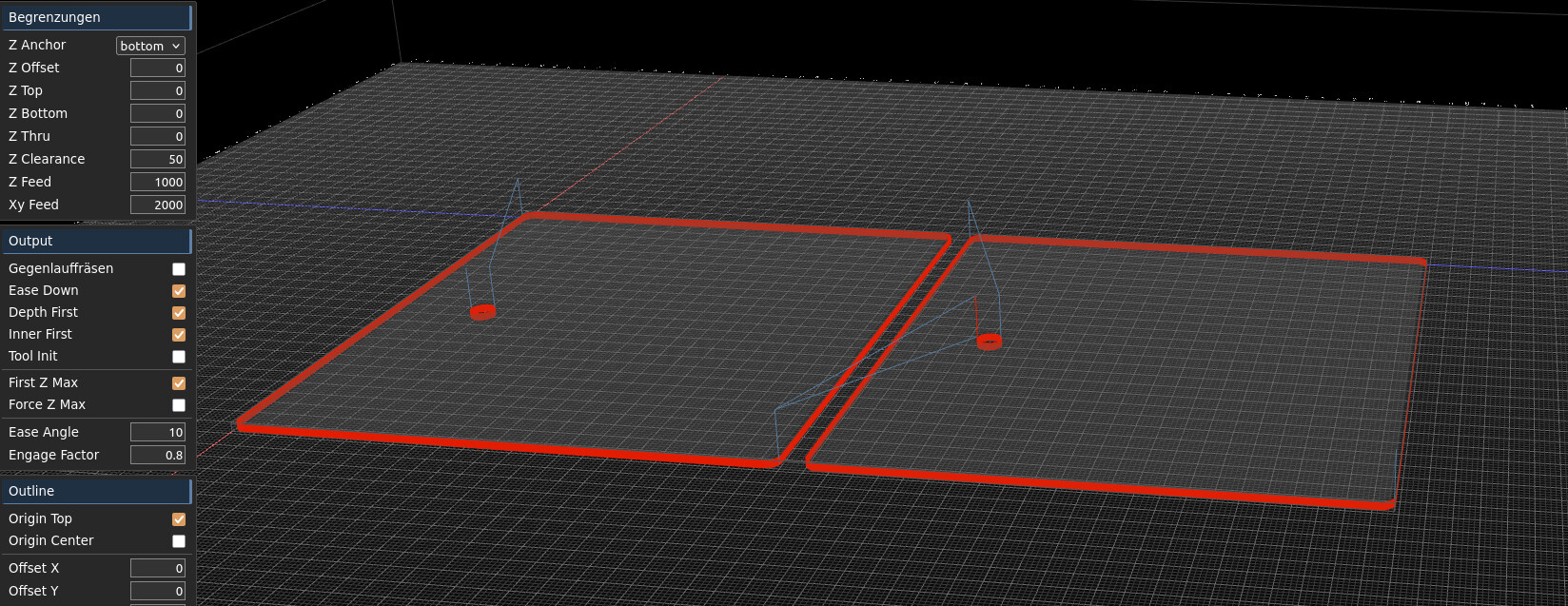

I am using the outline operation with no checkmarks set so it also does inner/pockets.
I have two simple parts with a pocket/hole.
After first part is finished there is an odd path moving back and forth between both parts not keeping clearance:

workspace_outline_path_error.kmz (1.3 MB)
should be fixed in 4.4 which you can test on the dev server
you can also merge object meshes to have them treated as a single part
