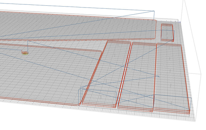

having only a trace and an outline operation in place, I see odd paths that leave the workspace (to somewhere XY first, some Z movement up and down and then back to normal:
I tried merging the meshes but then I cannot place tags anymore as KM wants to put them on top of the parts (matching lower edge of tag with upper most edge of part).
When disabling either Trace (first operation) or Outline, extra movements disappear.

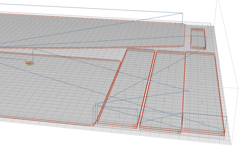

BTW: The bug mentioned in Unexpected odd path in outline operation is still present in 4.4.0 (see the blue “X”-shaped path in front and another odd movement like mentioned above to somewhere above the third part:

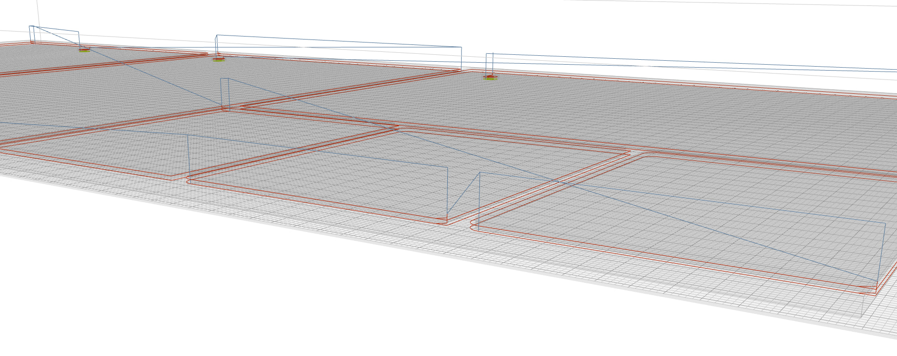

Cross checked on dev server:
movements outside the worspace have gone, but the extra diagonal G1 movements without respecting Z clearance are still there. However, the correct G0 movement at Zclear used to exist alongside but seems to be gone now:
