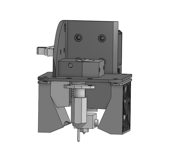

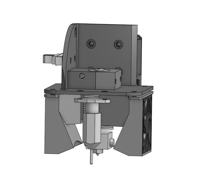

for better cooling, you really need either two fans or a more powerful fan with a fancier shroud. I ended up using an orbiter for my direct drive, which I like. It’s a bit of a pain to model the mount, but it does the job.
But this is only for version 2.5, do I understand correctly?
Do you use such bowden for 2.0?
That should work with 2.0 – it’s for a bowden setup, though
Don’t you use direct on 2.0? What model of airflow do you have?
At this point, all of my 2.0 printers have been upgraded to 2.5
I tried various direct drive configurations for 2.0, but was not completely satisfied. The 2.5 head mount is easily switchable between bowden and direct if you use an orbiter.
Great, I understand you. I already thought
on the transition to version 2.5, there and the print area will increase. So I will do it in the near future.

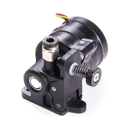

Just did not understand what kind of orbiter?
this is the one I used:
Thank you, I have not even seen this.
