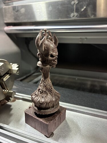

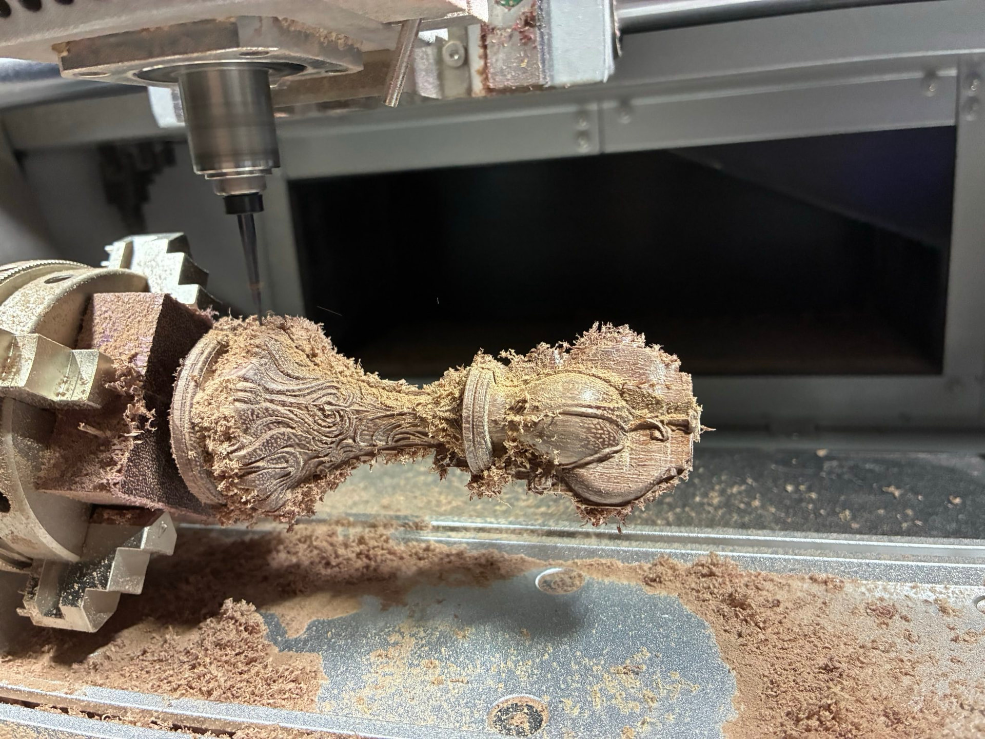

right now the king is in lathe mode running on the CNC.
The back of the skull is so perfectly round it’s shinging a bit:
I’m loving it so far :smiley:

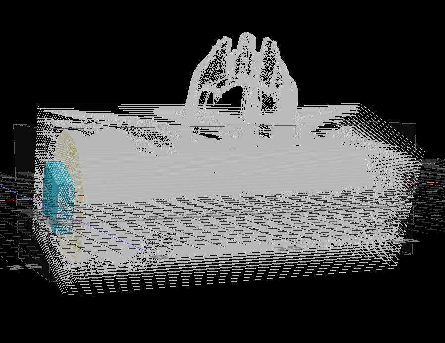

But there seems to be something wrong… maybe I did something wrong in a setting, but it looks like there is 1 with the orientation wrong or something:
it is a linear for sure
Strange.. only the linears slices fine:
rough + lathe is fine too:
But when slicing together it goes wrong.
I’ll slice it together again, maybe it’s a fluke or something…
I’ll send you this workspace when this slice is done.
yes, it’s consistent:

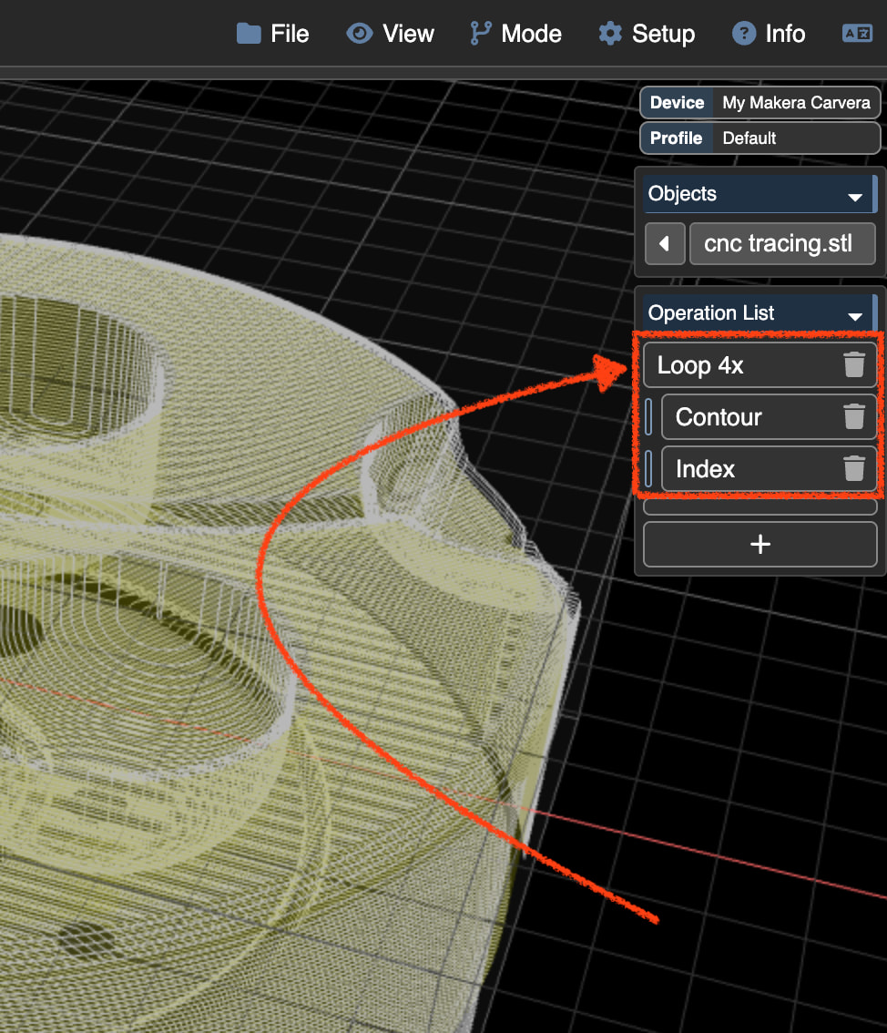

coming very soon to the dev server … this is going to massively simplify your operation chains

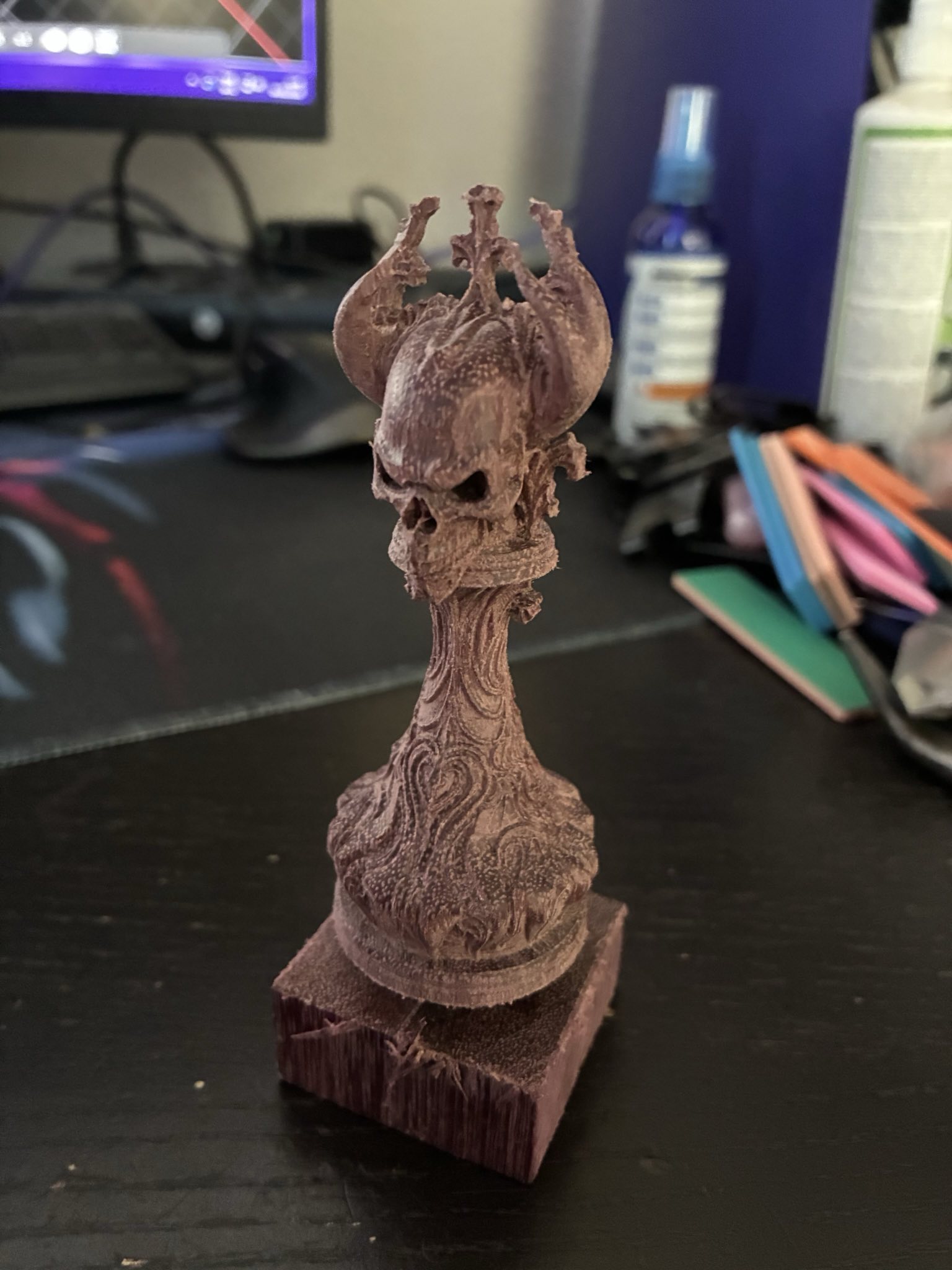

The king is born, and I must say, it’s spectacular :slight_smile:
I love the ball-nose algorythm makes the round parts flawless like it’s been polished.
I think I need a new precicion bit though, it looks a bit “hairy” like it has been touched but still fibres remain, nothing that a little scotch-brite can’t fix :slight_smile:

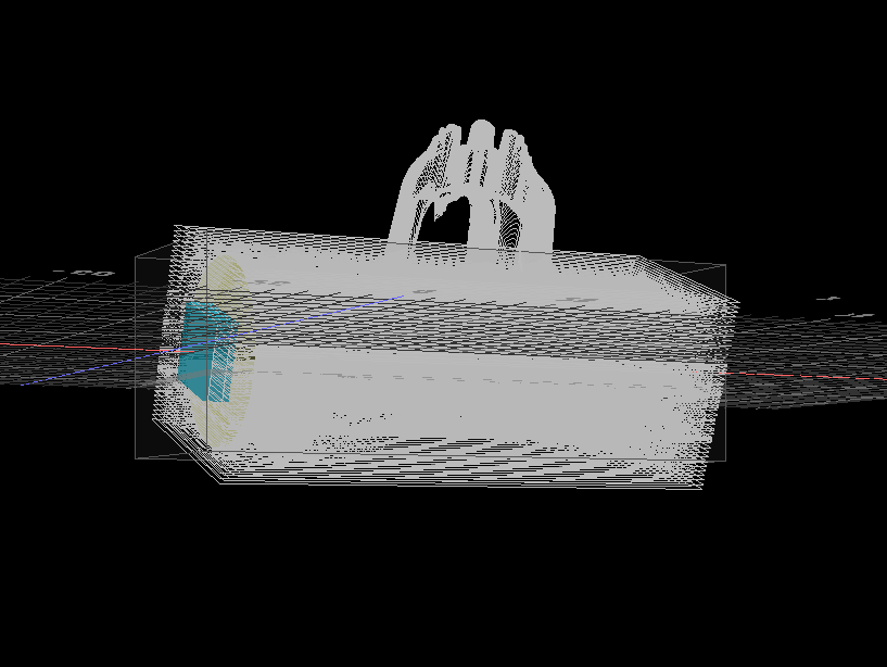

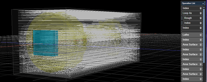

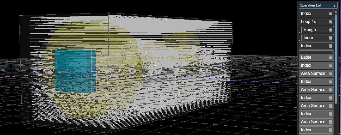

I’ve been trying with the rough:
if I do a loop of 2x 2 ops:
rough, then turn 180 degrees, then rough then turn 180 again (it turns back, not forward, maybe because 180+180 = 360 and that is 0…)
When I disable the rough in the loop but leave the index on I get nothing, no turning at all…

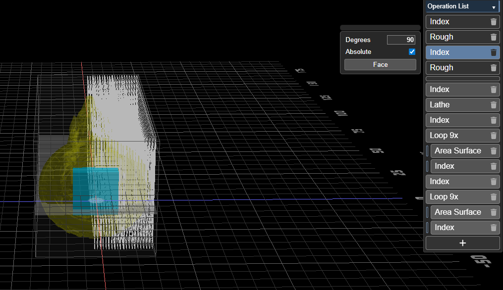

Then when I change it to 4 times and rotate 90 degrees it roughs still only twice
I do see it turn 90 and 90 and then it roughs the bottom.
I expected a rough vertical too in this picture…
When combined with the area it seems to be working ok, but also when you disable the area operation it’s not turning anymore, maybe it expects 2 operations and a disabled operation is voor UI there, but for the process not or something.

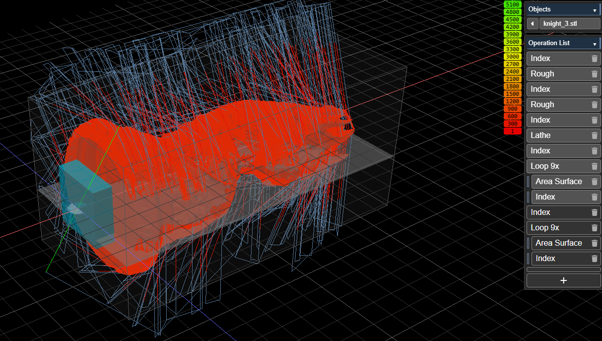

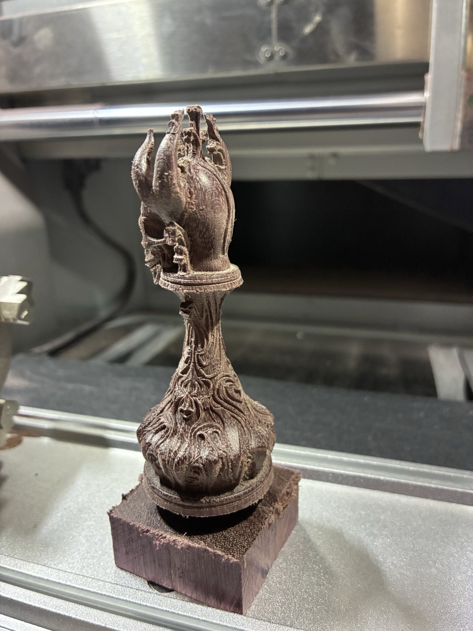

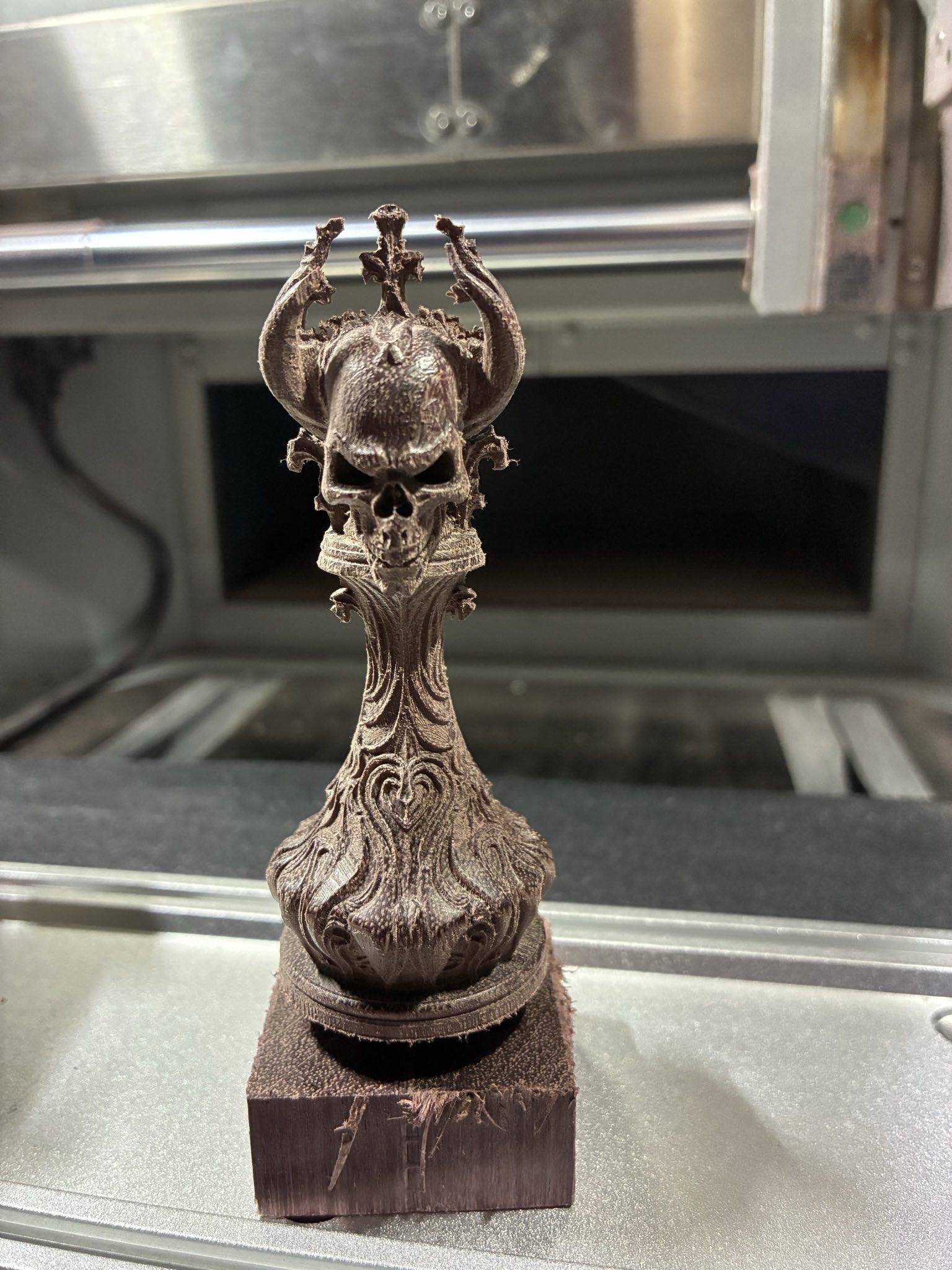

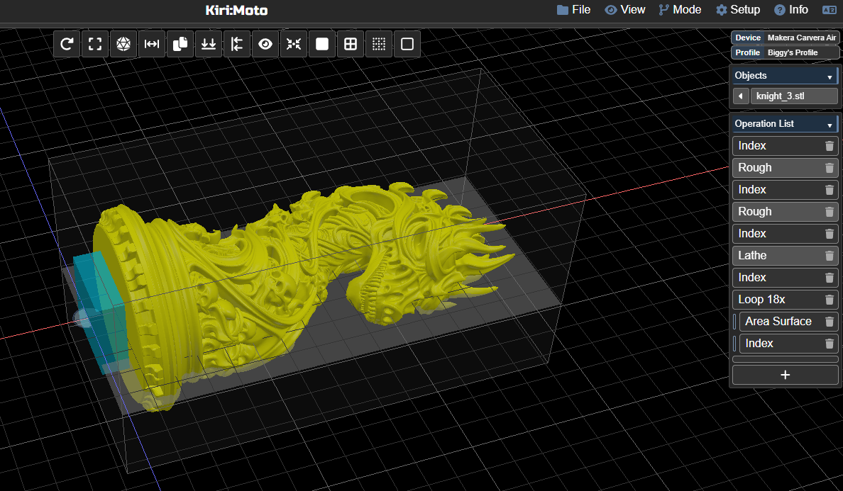

I’m going to make the horse in 3 passes: rough/lathe, erea 1-9 and area 10-18 generation of the NC code was fast and flawless.
04/01/2026 12:14 71.805.251 knight_3 - part 1 rough+lathe.nc
04/01/2026 12:16 65.531.295 knight_3 - part 2 area 1-9.nc
04/01/2026 12:18 65.093.746 knight_3 - part 3 area 10-18.nc
This is after baking, the color is not totally settled yet, need to “cool down” like 12 hours.
area surfacing should be faster now and use less memory. when you use indexing in a loop just be sure not to have absolute checked. when you have two index operations back to back and the second one would not cause any rotation change, it is skipped.
yes, I noticed that, logically, if you change to the same position you don’t change… I had that set correctly though.
I’ll do some investigation :slight_smile:

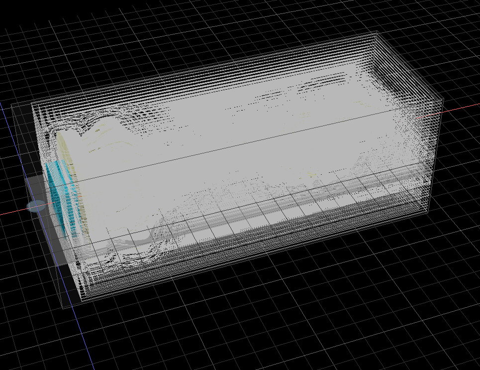

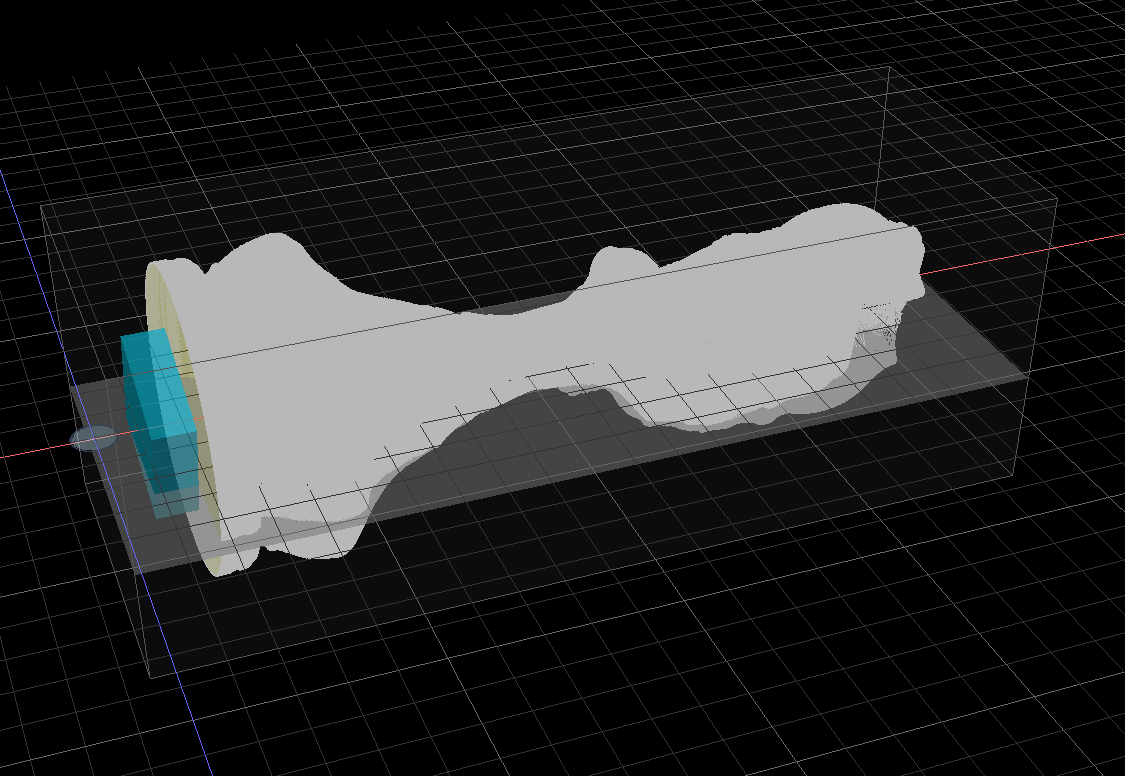

Yeah, it’s what I thought… the rough won’t work on 90 degrees index… only on 0 and 180.
but when I set the index to 180:

this was a subtle bug. fixed on the dev server now.
That must have been there for years :slight_smile:
funny how nobody tries these things.. I don’t see a need to rought at 90 degrees but I’ve been using it for a while now and never noticed it before.
