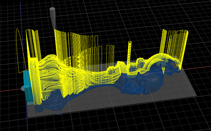

But what I noticed was that the contour passes I do after the lathe to get deep pocket from all angles have changed a lot, in stead of doing a pass over the axis over the whole object it just goes to a gap en then changes over to the next step, looks to me to be more efficient if it was not doing a Z-axis up and down every step. in version 4.4 it started and when it came to a gap in the line it moved up, moved to the next position moved down and went on like that, then it did a step to the next line and did that in reverse at a gap again up move to next pos and down.
But now in 4.5 it moves Z-axis up and down every change of step, and I do thousands of steps every up and down takes 4 seconds this adds hours to my milling time.
I thought this process would be more efficient to change the path for a gap to a step and go on like before, that would have saved me a lot of time moving the Z-axis in version 4.4
I think therefore it’s a bug and shouldn’t be doing the up/down every change of step.
Illustration of the path going up/down every few millimeter of milling:
I couldn’t get the older version to run or else I would have taken a screenshot of that path too, but it keeps loading kiri:moto, only the current version runs on my system.

I can see how the new path could be way more efficient if it’s not constantly going up and down, it would drastically lower the up/down movements with the new pass, I think that was the aim too, but somehow it went wrong :slight_smile:
I’ll try to DM it to you, it’s quite large.
got it and testing. I have a more clever contour routing algorithm for gpu that will be in the 4.6 release … which is in progress.

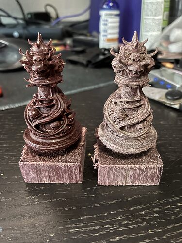

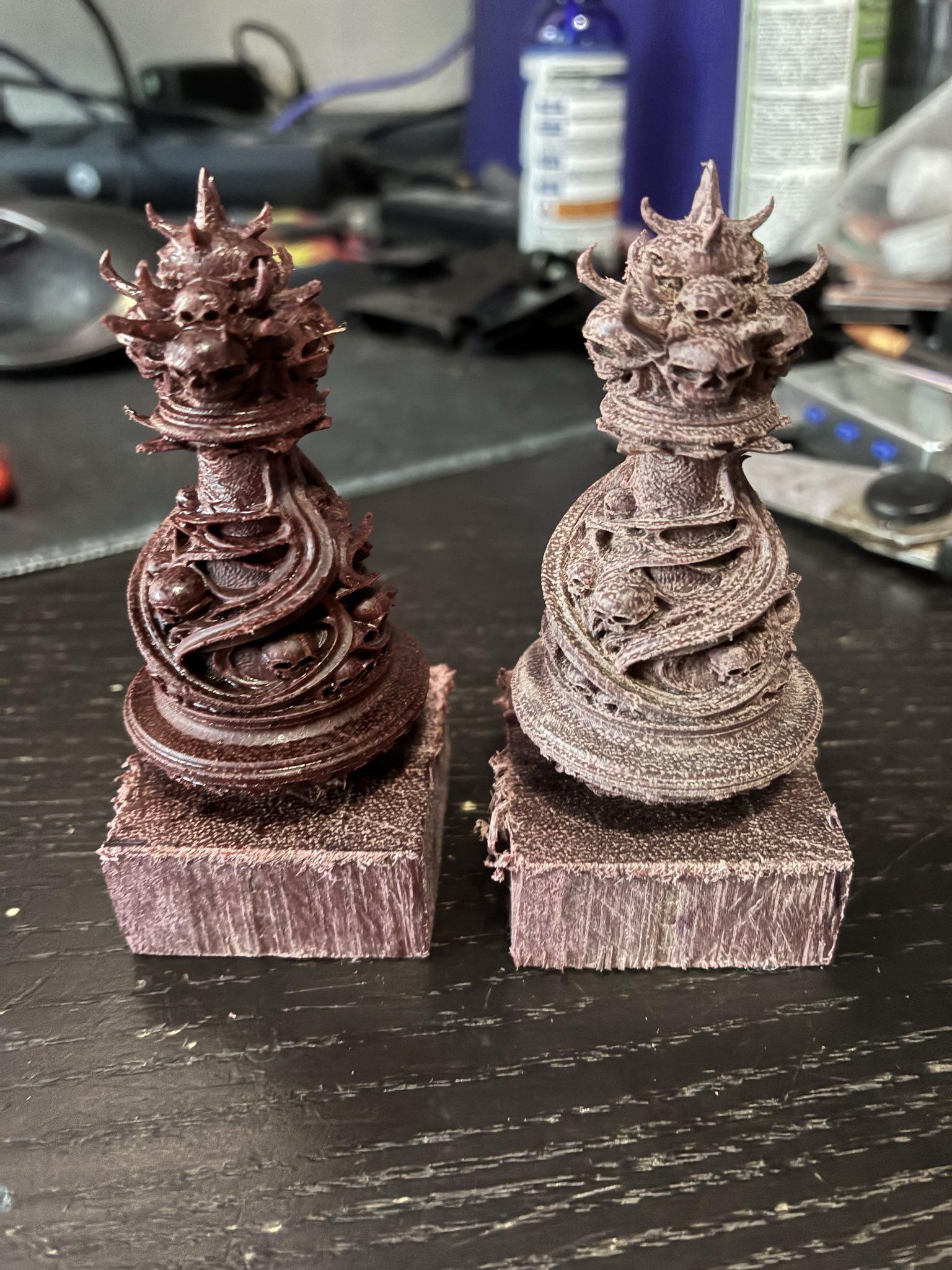

It’s not an equal comparison as the one from 4.4 is already in the Osmo, but here is a compare with the tapered ball-nose bit setup as flat nose (left 4.4) and setup as ball-nose (right 4.5) the new one needs baking in the oven and a 24 hour cool down period before I kan put it in the oil but I see the round surfaces are more gradual, more flowing. it’s a small difference though, it took way more time (didn’t time it) to mill because of the up/down every time.

The ball-nose detail is very nice though, round parts are a lot smoother :).

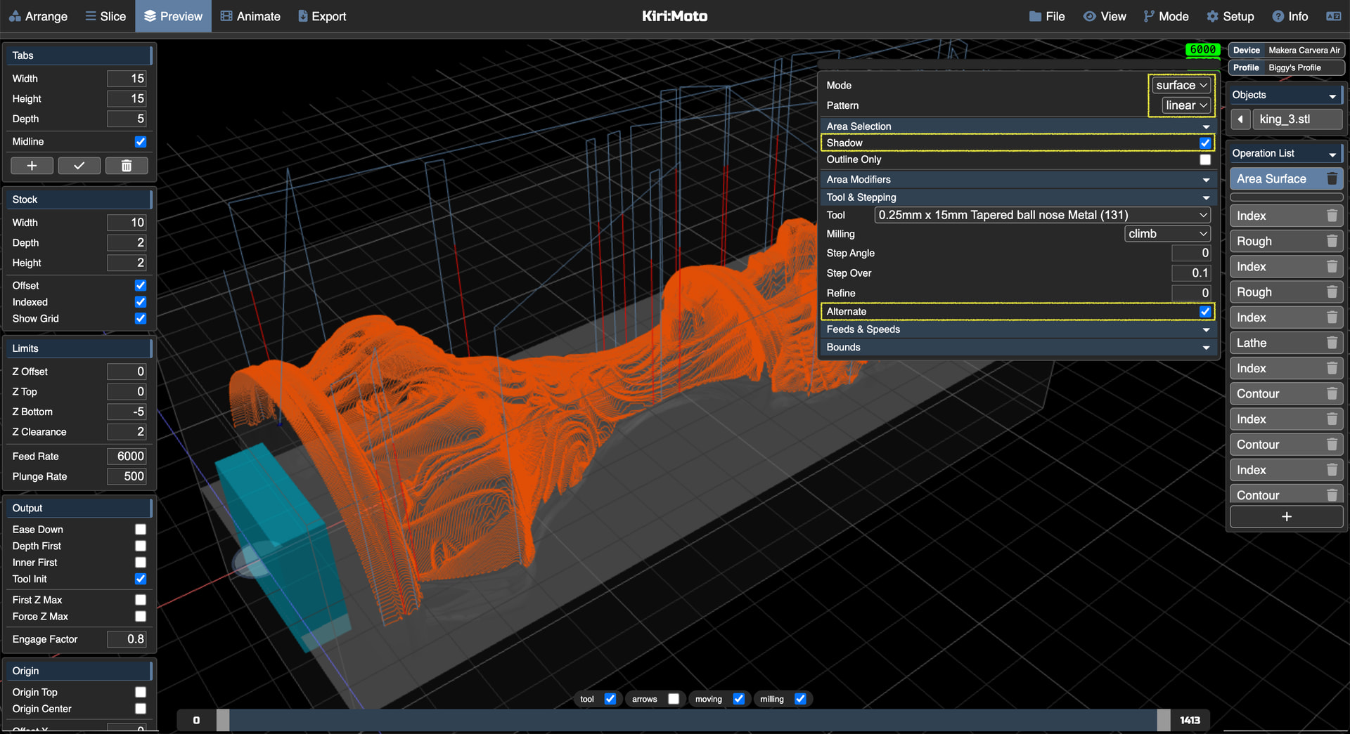

I have an update for you to test, but it’s using a new variant of the area operator instead of contour … does the same thing but more efficiently.
try out areasurfacelinear with shadow and alternate selected
on the dev server

wait a minute, this looks to be way too fine, did you change something in the step over values? it was always calculated to the shaft of the tool but it looks to be way too small now… I had to enter for the 0.25 mm ball-nose a value of 0.0393 to get to a stepover of about 0.1 - 0.12 mm but now it looks like it’s way smaller, is the stepover calculated to the with of the tool nose now?
Is the stepover value an absolute value now? so I need to enter 0.1 (for 0.1mm stepover).
Yes, it looks to be absolute now :slight_smile:
that makes my stepover 2.5x more passes no wonder I’m running out of memory :slight_smile:
taper tips use absolute values for stepping whereas non-tapers use fraction of flute diameter
That explains a lot, changed it to 0.1, I think I can generate NC in 4 passes per file now…
