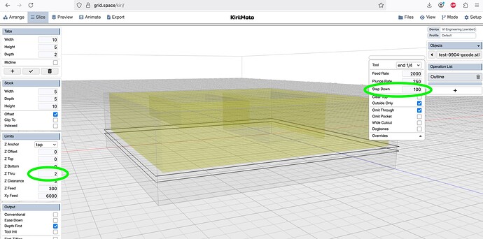

I am sure that I am missing something, but I can’t seem to figure out what. I love the “Z - Thru” feature, but I would also like to cut my part out with a single full depth profile cut. Z-thru always adds a second pass.
Is there a way to cut the part all the way to the full thickness + plus some extra in a single pass?

The current design of cut thru is to add additional “step down” passes below the lowest pass. So if your step down was 1 and cut thru 3 you would see three additional passes. This could be changed, of course. But there is no option for that at this time. I suppose it’s a special case when the step down exceeds the total cut depth and this could be detected and turned into a single pass when cut thru is enabled
