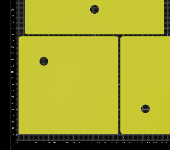

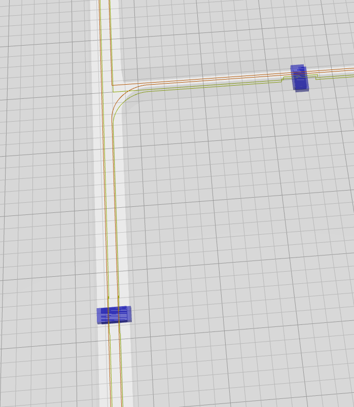

Consider an (expensive) 10mm Plexiglas element of that size: it is really heavy and will not move when cut. But when parts in nesting are plaeced really close (diameter of tool… here 8mm) the tool passes the same path twice (one time for each part). Then tags are a must!
After that you have to get the tags cut to take the elements out of the nesting.
Example (cut with 8mm tool and a spacing of 8mm between parts:
