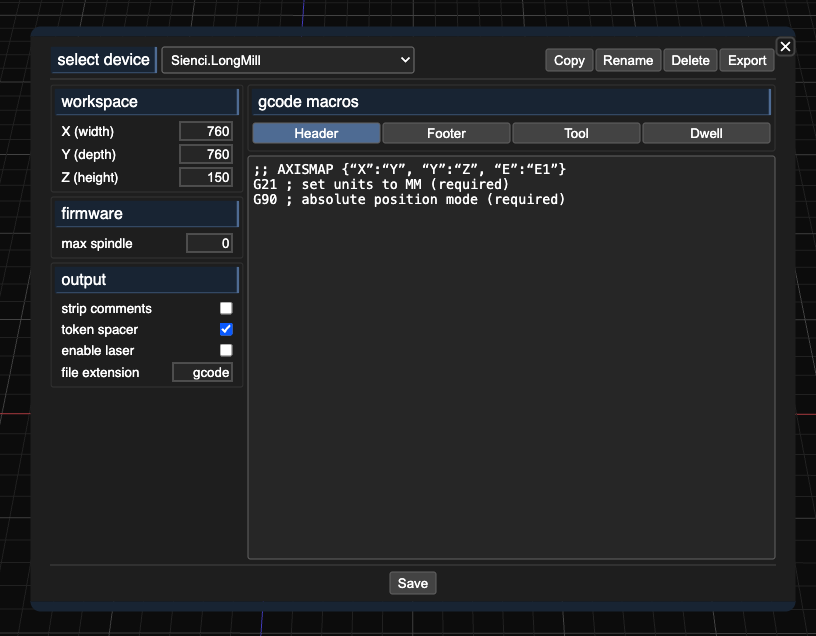

check out this post for an example of how to remap axes
full gcode reference at docs.grid.space
thanks Stewart, I have already seen this post, and I don’t know what to do with this line
;; AXISMAP {“X”:“Y”, “Y”:“Z”, “E”:“E1”}
were do you insert it?
add it to the gcode header macro of your device like so
Many thanks Stewart, Gcode is OK.
Stewart,

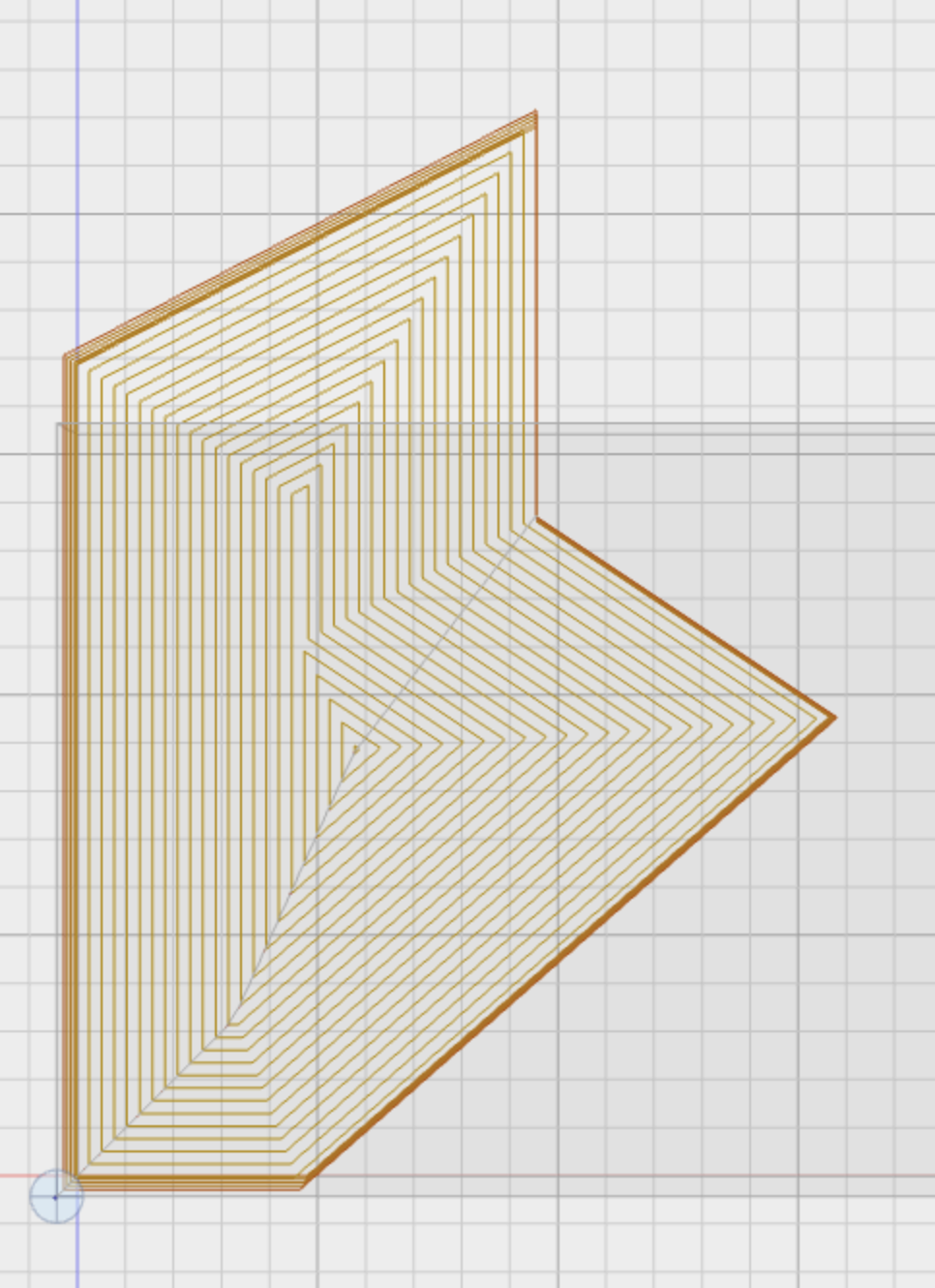

;; AXISMAP {“X”:“Y”, “Y”:“Z”, “E”:“E1”} give an error on Gcode generation

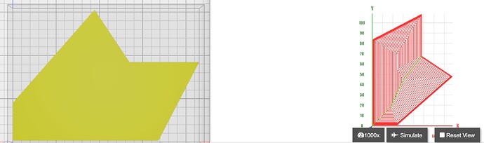

the use of ;; AXISMAP {“X”:“Y”, “Y”:“X”} work, but
give me a symetrical cut of the part (see picture)
any idea?

swapping XY axes will cause the part to be mirrored around a 45 degree line
Stewart,

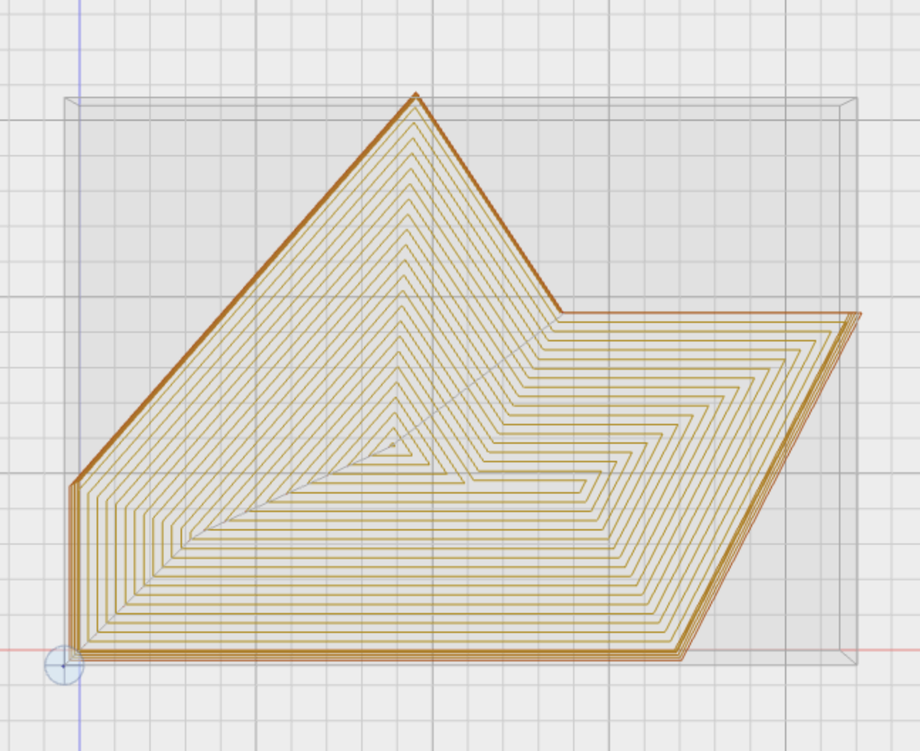

A axis should be on the Y axis, I only take this sample to explain that the part is inverted with the command ;; AXISMAP {“X”:“Y”, “Y”:“X”}
the part is not conform to initial stl, but symetrical.
Is there a way to have something like Y =X and X = -Y in order to respect the objet design?
for a “today” solution, it might be easier to mirror the part (M hotkey in Kiri) – there is an axis scale option, but that doesn’t take formulas so it would result in negative axis values.
