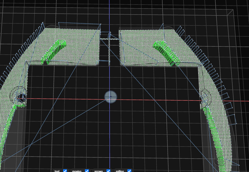

Why will this workspace not contour?
Workspace will not contour, could I please get a pointer as to what I am doing wrong?
workspace_Jig_cutout.kmz (612.6 KB)
I can’t tell exactly what’s going on from that screenshot. I opened your workspace and did two things
  1. disable curves only
  2. provided an area op alternative with specific surface selection
Jig_cutout_area_alt.kmz (1.0 MB)
Thank you. What is happening is the contour is showing up on the bottom of the part not the top. I will have to learn the area op command.
interesting. your workspace opened and contoured properly for me. try opening the workspace in a private browsing tab and see if the behavior is different.
Yeah I did before I submitted a thread. Not sure but thank you so much for the help.
