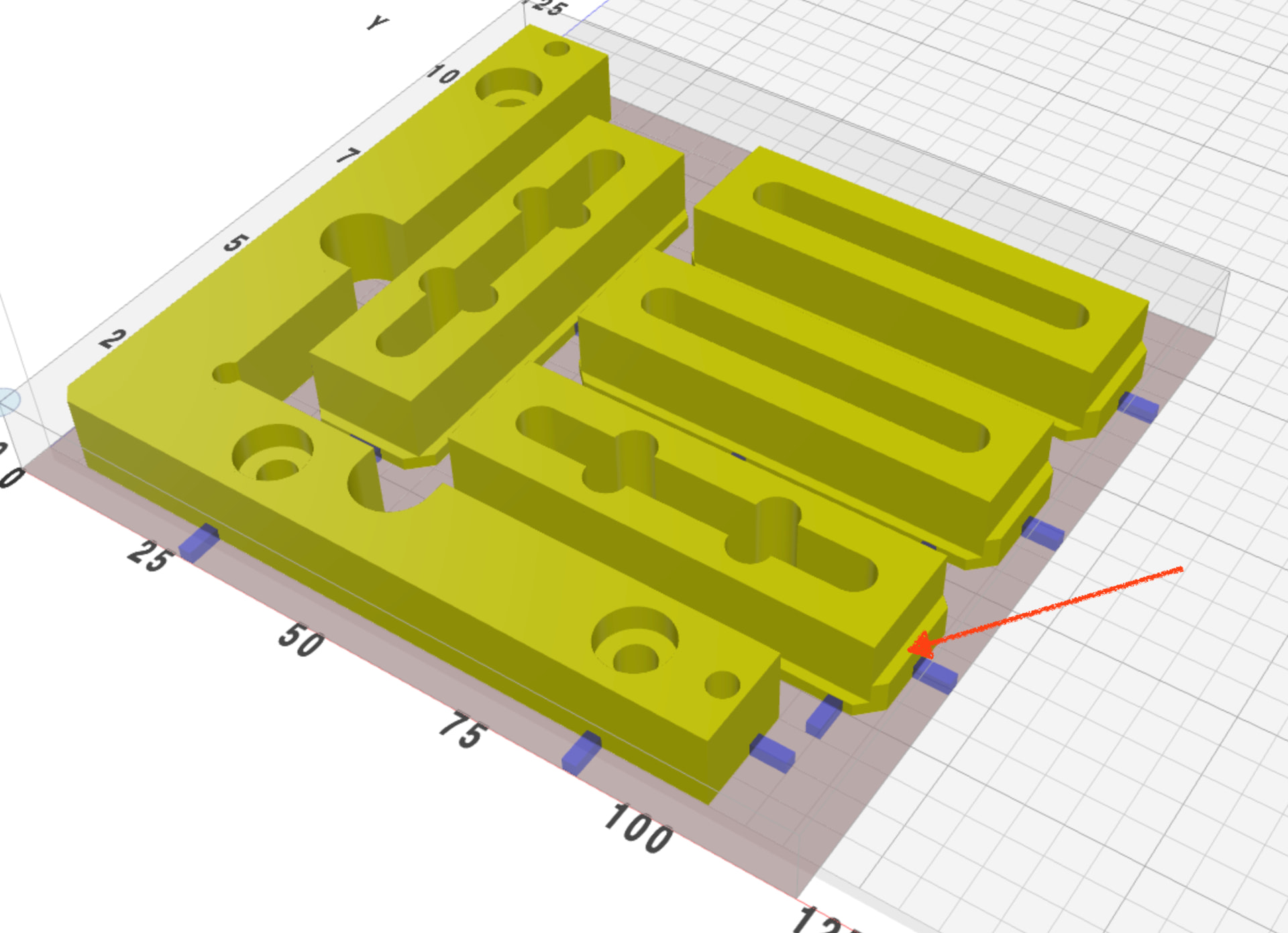

Why all the vertical cuts?
I am at a loss. Been trying to make this work for hours and hours.

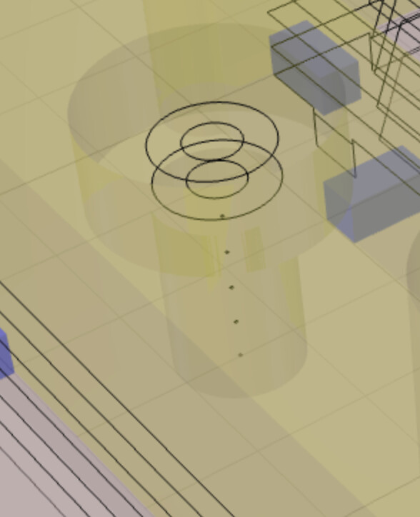

First, run the Animation. What is causing all the z movements? What can I change so that it cuts more laterally rather than vertically?
Thanks,
Ken
workspace_isolate_0_of_merged.kmz (334.5 KB)
I think I just answered the question. Should use outline, not contour.
are you referring to these holes? also, contour isn’t a natural fit for geometric parts. it’s meant for contoured surfaces. was the intent to clean the lower ledges? I would have used a trace for that.
I was confusing KM contours with Makera contours. Outline seems to be working in KM although I haven’t done a complete milling of the part with the lips due to having broken 3 1/8” bits so far. 1/4” bits are ordered.
I’m also unclear as to what Outlining does because I don’t understand what the shadow line refers to.
