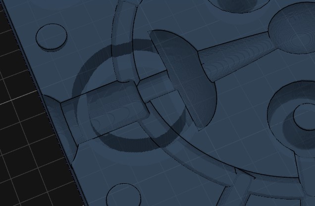

Looks like for some reason when I use my 2mm flat endmill I get a weird circle at the end of my tool path.
here is my workspace. Other tools do not seem to have this issue.

I lied now my 4mm flat endmill is doing the same thing.
this is exposing a couple of bugs related to arc processing even when arc processing is disabled. please drop back to 4.1 until this is resolved.
one temporary workaround, not ideal, is to disable depth first
@BakedPotatoLord this impacts 4.2 and 4.3
Thank you, if I turn off depth first then run an animate then I turn it back on the glitch does not seem to happen. Thank you again for all of your hard work.
I’m working on a patch to 4.2 and 4.3 that properly disables arc conversion that I will push to production tonight. Please verify tool paths before running a job.
