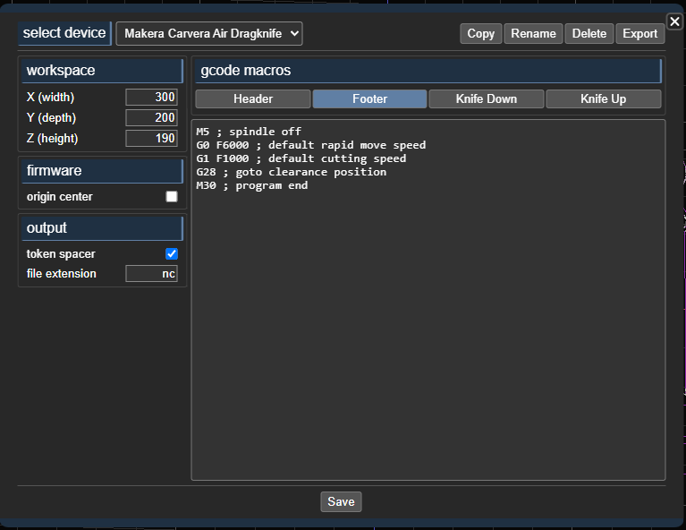

I’m playing around to makeshift my Makera Carvera Air to be used as a dragknife.

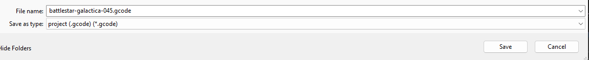

I’ve set my machine information so that the file-extension will be .nc
But when saving my export it suggests .gcode
Looks like my preferred file extention is ignored.

The file extension works for me in 4.3.2. Can you provde a workspace?
are you sure? I’m in drag mode.
workspace_battlestar-galactica-seeklogo-3.kmz (320.4 KB)
Ah, yeah, I tried it in CNC mode. In drag mode it does indeed seem that the file extension is hardcoded and ignores the field in the machine configuration.
