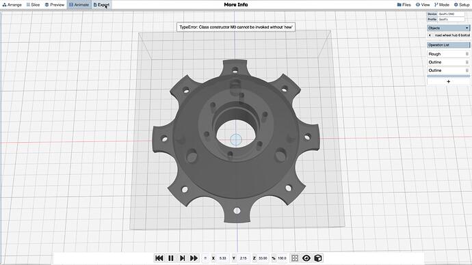

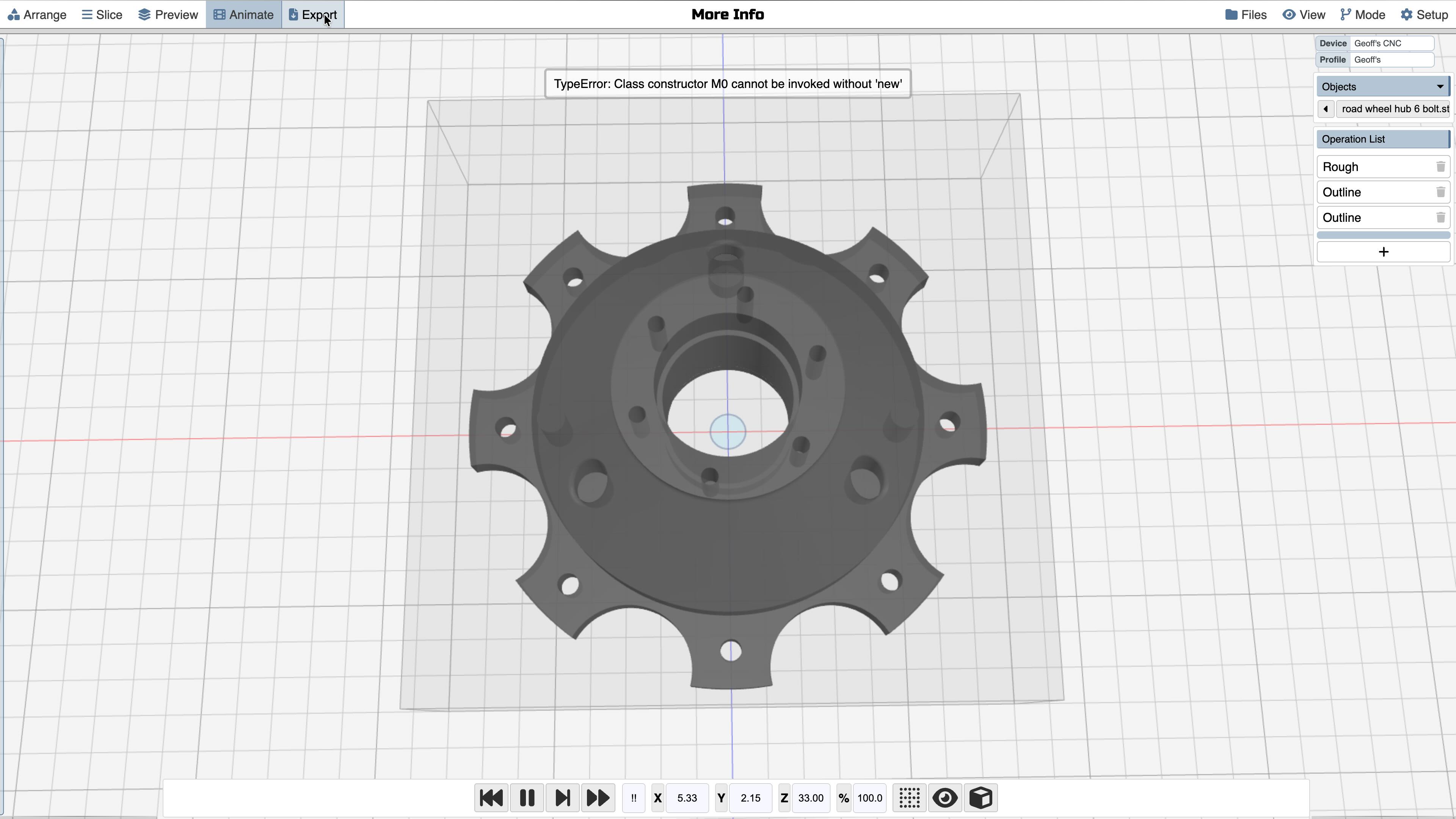

I use Kiri:moto installed on my Mac which is running OS26 and the problem appears when exporting/saving my projects to file.
The warning first appeared on version 4.3.0 and I was hoping version 4.3.1 would have fixed the problem but it still is present.
I don’t really understand what the warning means, is it caused by me getting something wrong?
Is there a fix for this error or is it a bug in the software?

The version of MAC os is Tahoe 26.1 public beta build 25B5042K.
The error is produced from the two latest releases of Kiri. Version 4.3.0 works fine when working with OS26.

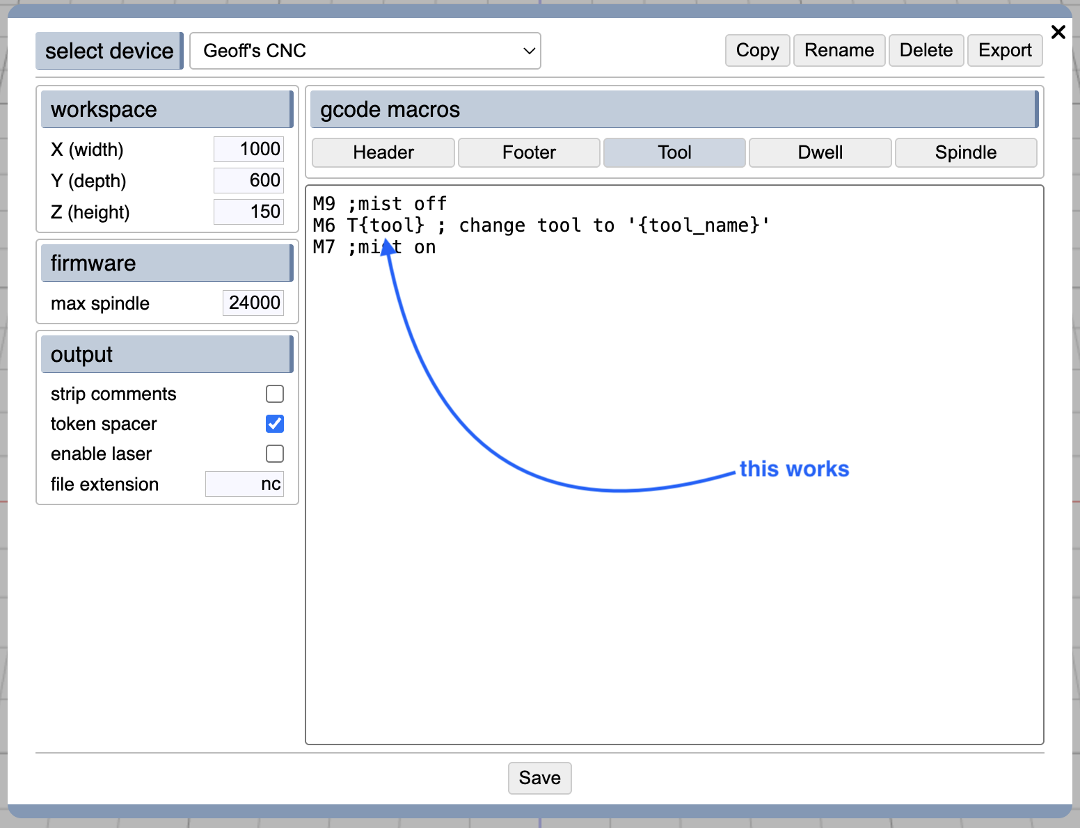

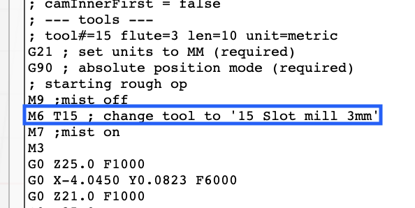

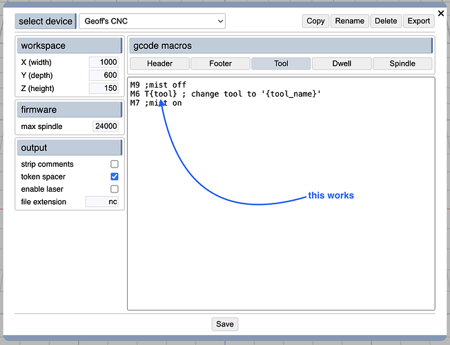

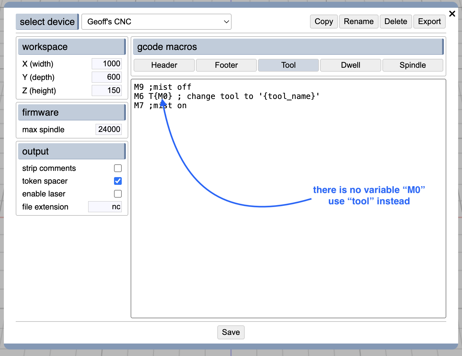

the error stems from the fact that “M0” is not a valid variable name. I think you want to use “tool” instead. if your machine requires different gcode for a tool change, please describe or link to docs.

Hi Stewart,
I tried your suggestion and it works perfectly, thanks.
