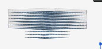

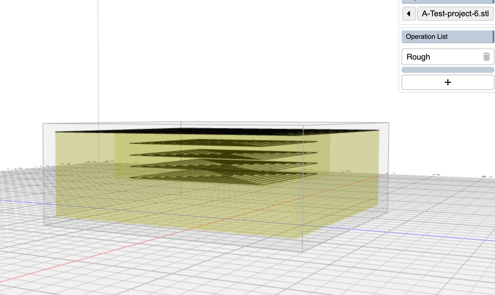

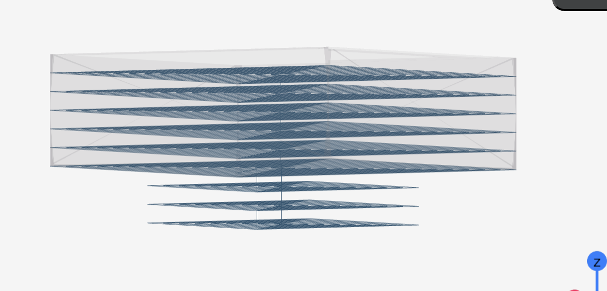

I’m still however struggling to replicate the slicing results i get on the grid.space using the same file and process settings. What I’m expecting is the result on the right but what i get is a version that seems to go include outside roughing and go through and beyond the depth of the part.
Do you have any sense on what might be causing this error or what settings I might need to take a second look at? The only process setting i set differently was the “camZBottom: -25,” to get around the bug, otherwise every process setting is the same as i grabbed it from grid.space.
this looks like a z / stock alignment issue. it’s introducing a lot of cuts above the part that match the stock profile. please send me your workspace .kmz and engine code (settings/profile) to replicate and I’ll figure out where in the engine code the calculation is going wrong.
