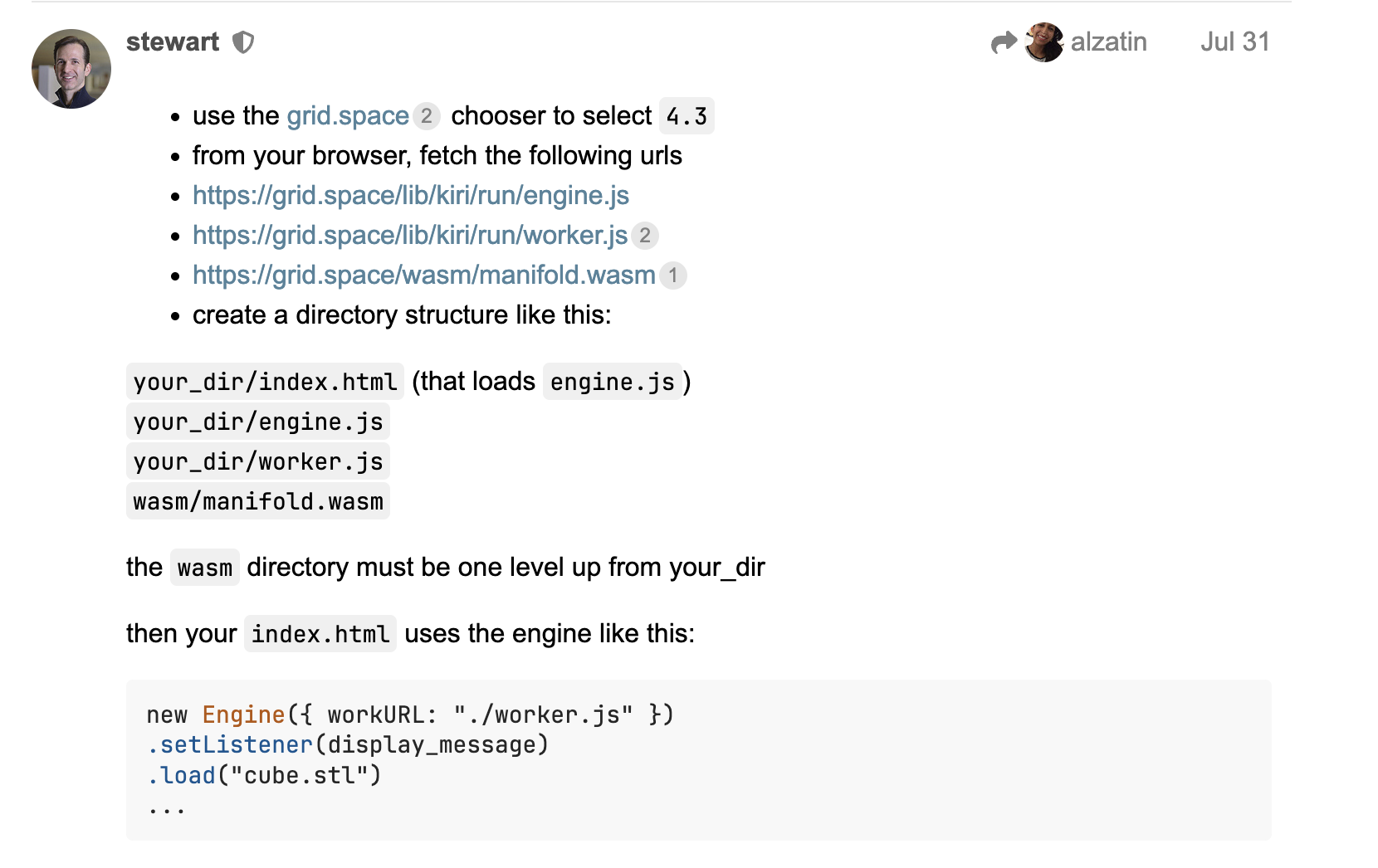

I’ve been trying to update the engine and worker files, which i run locally and set up back in july following this example (image). However, when i pulled the new files today to keep up with some of the most recent updates, I’m now getting an empty gcode file. Is this still the correct setup, is there possibly a file i’m missing to update. The engine seems to load correctly as 4.3.4 but simply not giving correct results.
I’m not aware of any changes that affect this. grid.space/kiri/engine.html is still working in production as well as my local machine. are you seeing any javascript errors? are the files loading normally?
The files seem to be loading normally, but now I’m thinking it might be an error with my settings. Is the settings example in Kiri:Moto up to date (with the setTopZ bug hack)? Or do you happen to have an example settings for a CAM operation running in the most recent update? Thanks for the help! :slight_smile:
