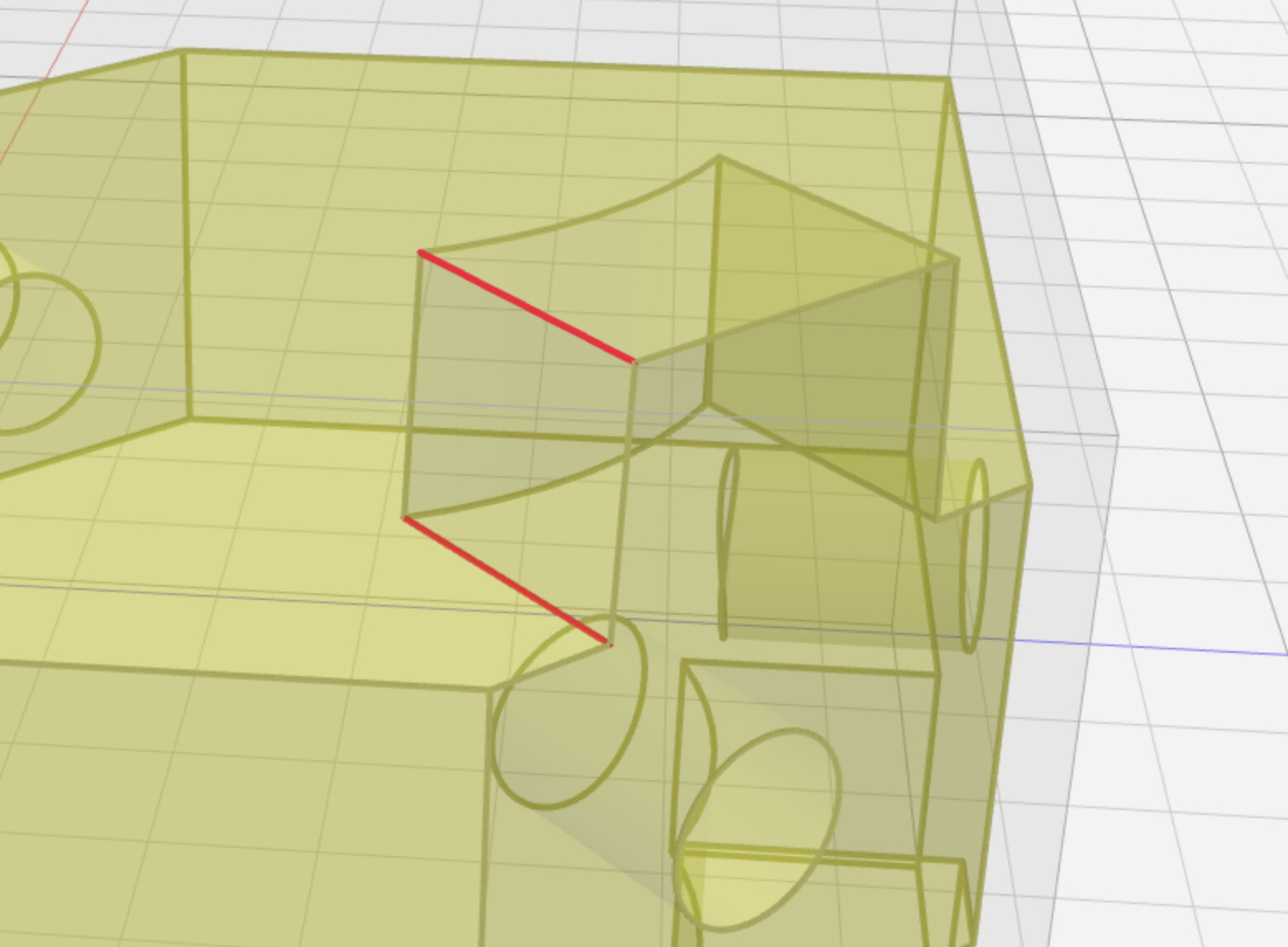

seems like there is a problem with 26
workspace (25).kmz (239.0 KB)
workspace (26).kmz (259.6 KB)

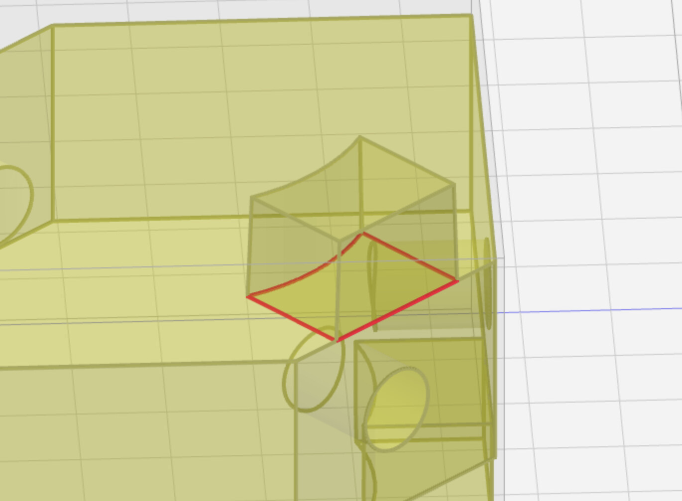

this leads to undefined behavior. trace expects only the bottom cut line to be defined.

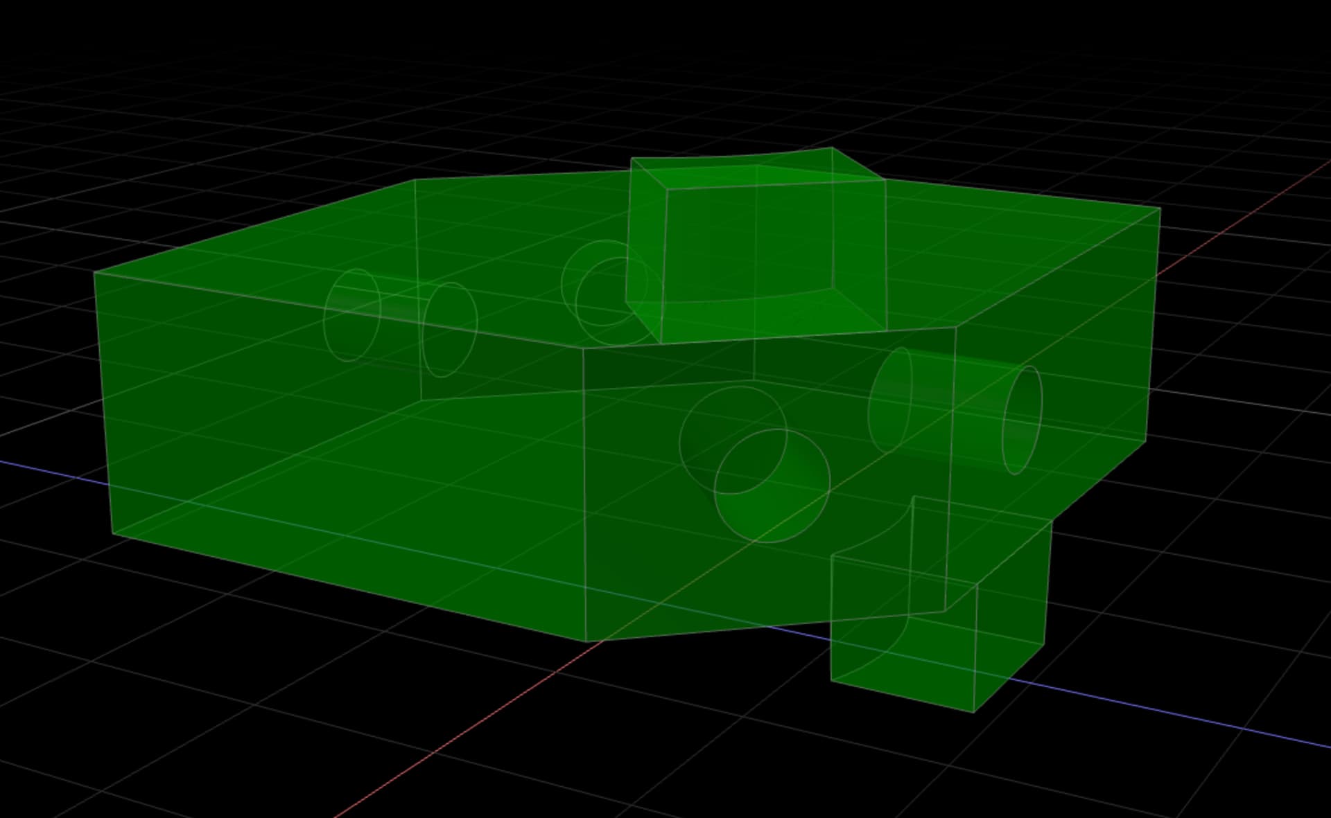

I used Mesh:Tool to split the body into three parts but kept them in the same mesh. Then I was able to use trace to select the base and produce the path I think you want.
part-split.kmz (442.6 KB)

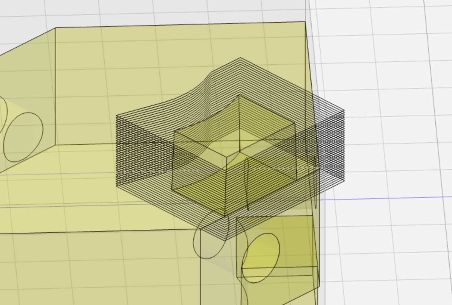

there is a slight taper….25 cut it correctly ….I’m good but thought it might be a bug
