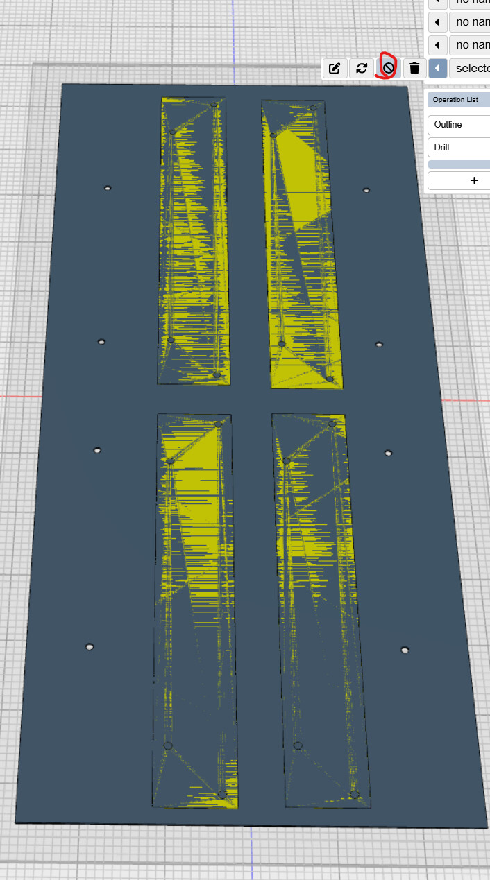

I’m not sure what you mean. The files load fine for me. Are you saying that you cannot load the meshes at the same time?
I’m glad your workaround works!
I’m still a bit confused about what the problem is, as I can load both meshes into KM.
If you only want to cut out the inner pieces, there’s a disable button for each widget that you can use to only generate toolpaths for specific widgets.
Hope this is helpful.

the disable worked great
