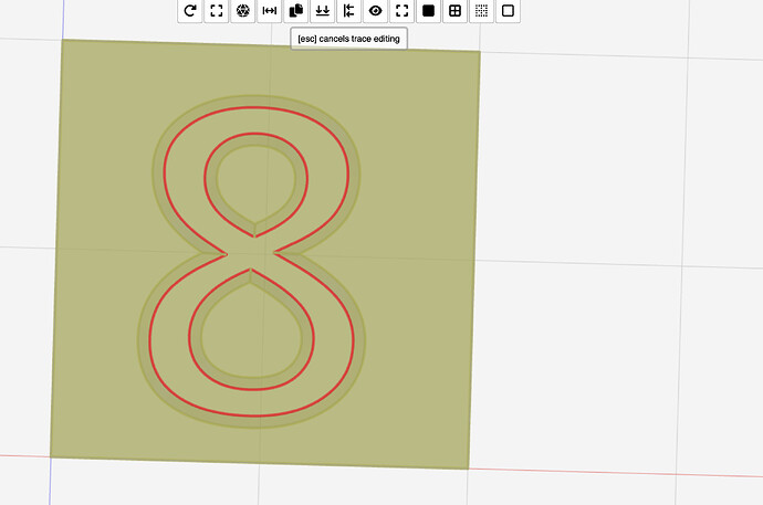

Just curious, what other issue did you find?
the inner polylines were not on the same Z plane as the outer and selections. it was related to a bug fixed (partially as it turns out) a few days ago. two function parameters were swapped.

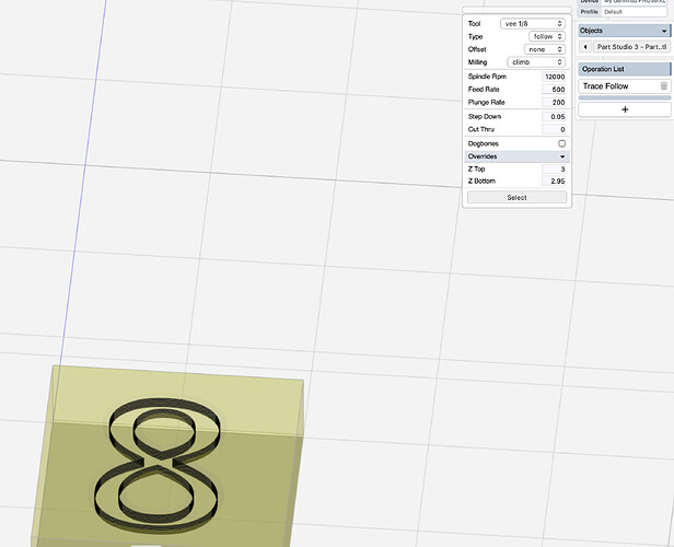

Not sure if it’s related but I’m unable to set Z bottom. It’s just being ignored. The stock is 3mm so it should only slice a single step down.
yep. found. try it now. a few lingering compatibility issues with the older outline op.
Awesome, that fixed it. You are incredible!
