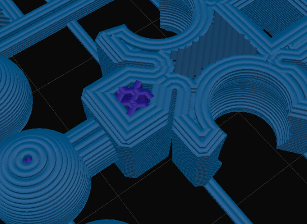

Top layer line is not getting added
Not sure if the subject makes sense, but all of my models are lacking a top layer, and it’s kinda important (visible inside supports in picture )
under the solid fill menu change min solid to 0 and see if that fixes it. was it defaulting to 5? that will elide small tops
Thank you. that seems to have helped.
