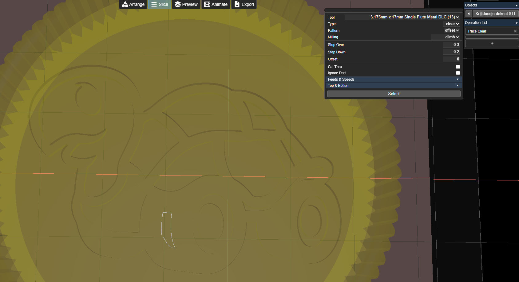

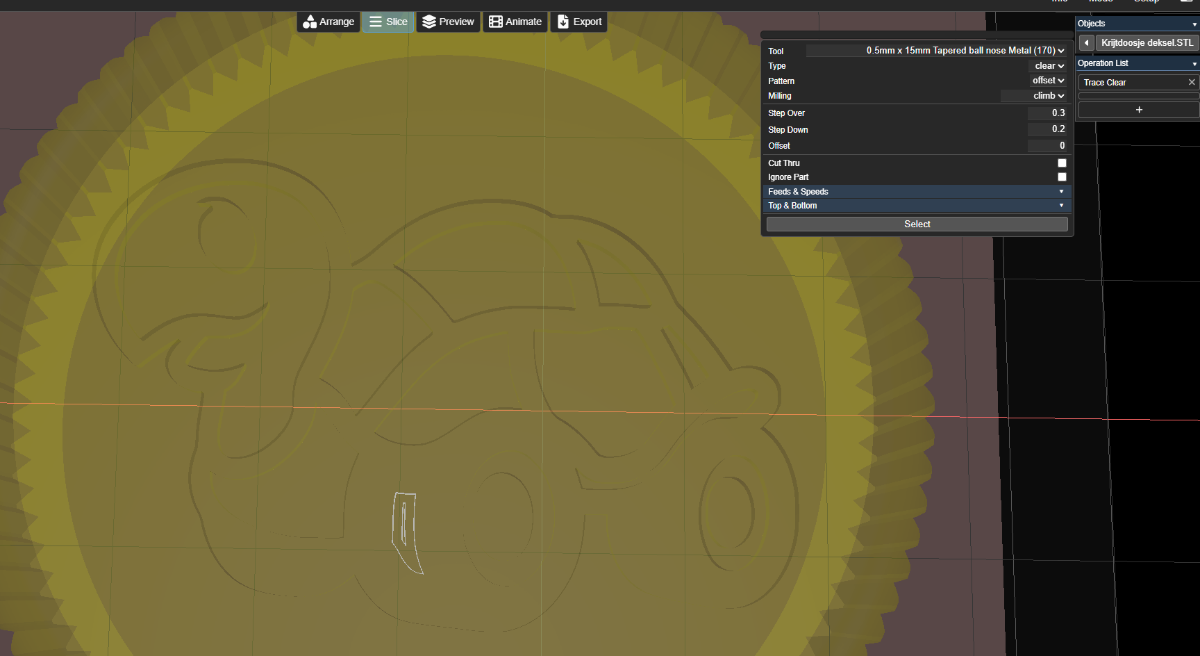

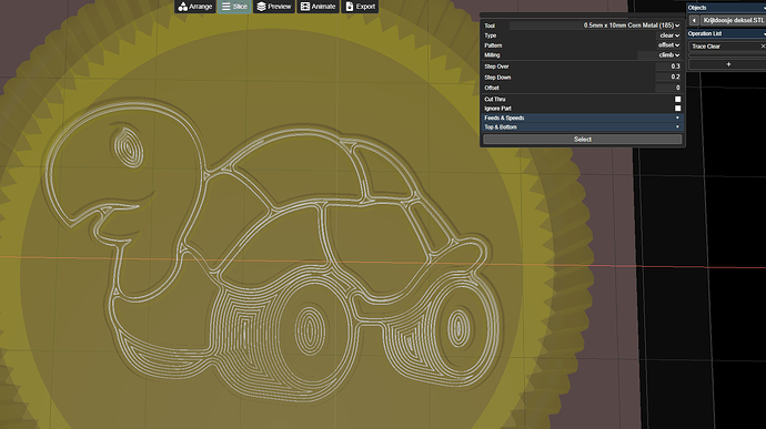

Hi,

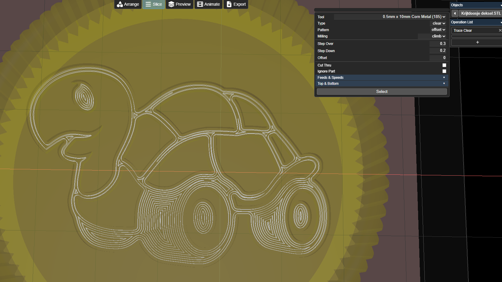

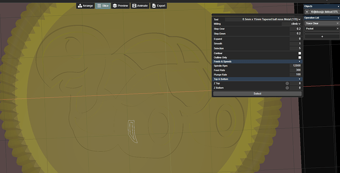

When I select a 0.5mm straight corn bit it looks to be working fine, but when I use a tapered bit it looks like it’s calculated from the shaft diameter in stead of the tip diameter.
0.5mm Corn bit:
0.5mm tapered ballnose (with 3.175mm shaft):

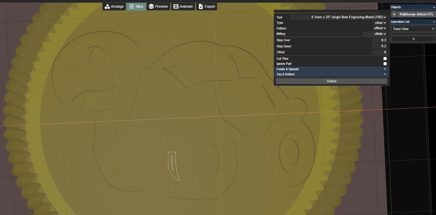

0.1mm 20 degree engraving V-bit:
3.175mm flatend bit:

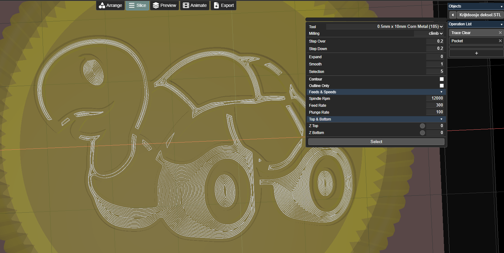

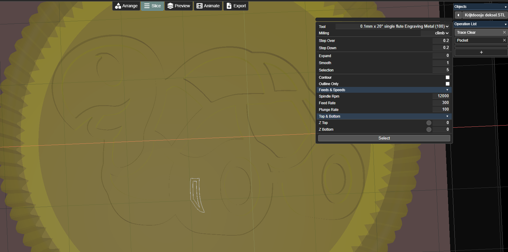

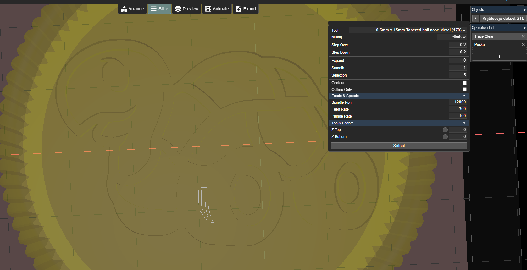

I’ve about the same with the pocket op:
0.5mm corn bit:
0.5mm tapered ballnose:
I’ve seen this on the production server, transferred to the dev-server and got the same.

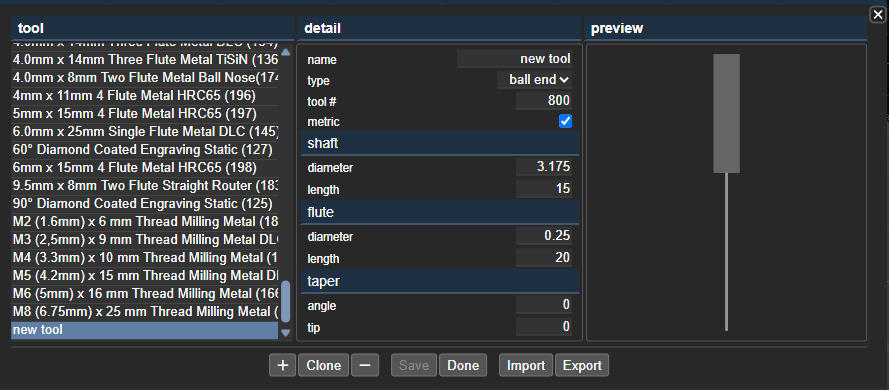

I’ll take a look, but I thought it would use the tip diameter unless that was 0
I did a work-around to make a straight ballnose bit of 0.25mm :slight_smile: and just use the tapered ballnose bit for real, I just needed a 0.2mm deep pocket.
