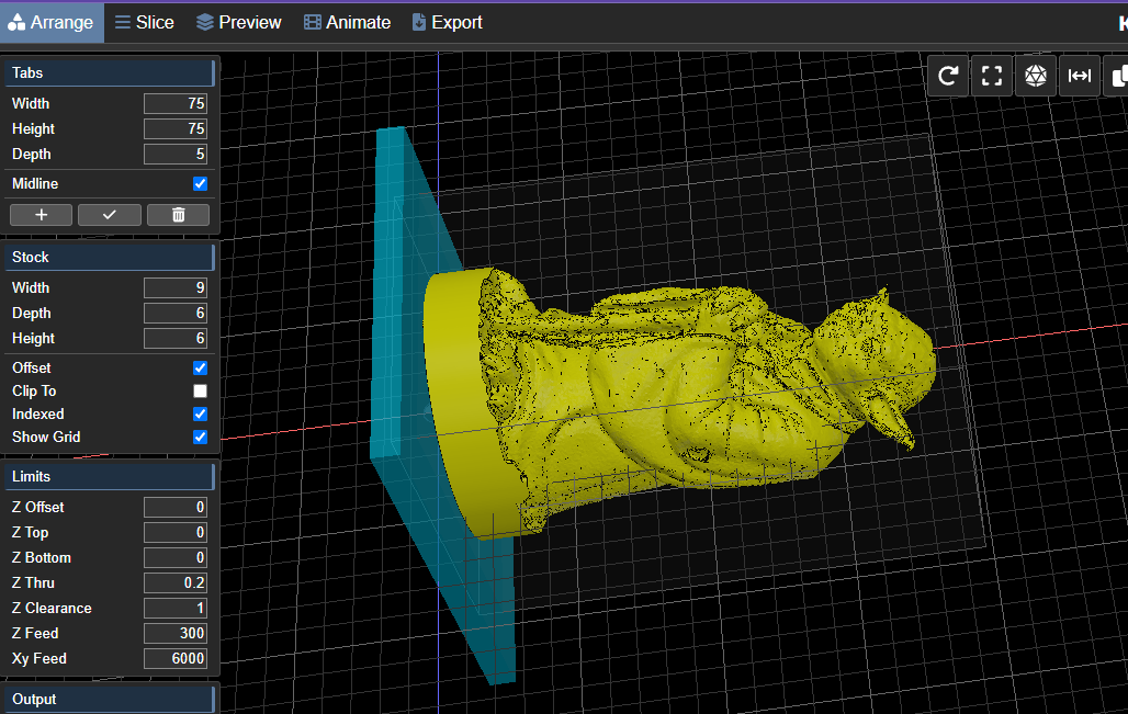

Hello,

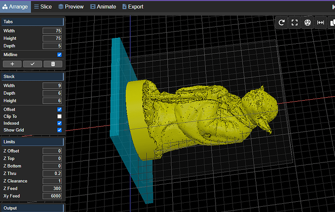

I think I found a nother little bug, when I deleted the tab on this image to make a new and slightly bigger one I did see the old tab being removed, but when I moved the mouse over the object I didn’t see an example tab, when I click a face I don’t see a tab being there, but when I close the browser and open Kiri:moto again it’s there :slight_smile:
So it does work, but you can’t see it.
Thought you would like to know.
I was in this workspace:

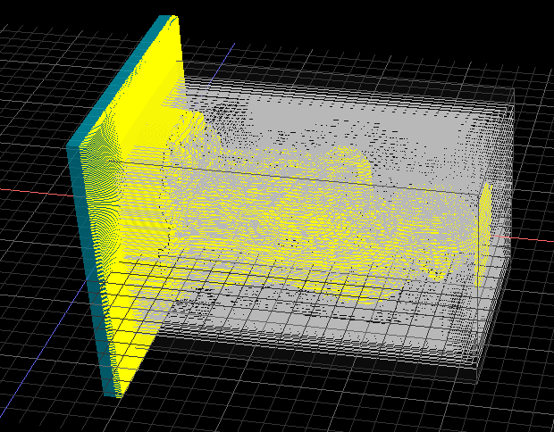

I’m experimenting with lathe option combined with contour in some parts where the lathe can’t reach.
I had to increase the no-go zone to clear the clamps of my lathe, as the lathe mode would not stay inside stock and go arount the tab… maybe that’s a bug too:
thanks for the workspace. lathe mode has a few bugs.
It is milling now, detail looks great, I only hope my machine’s Z-axis is high enough to clear the corner of the tab when it has a corner up, looks like it’s going to be close…..
