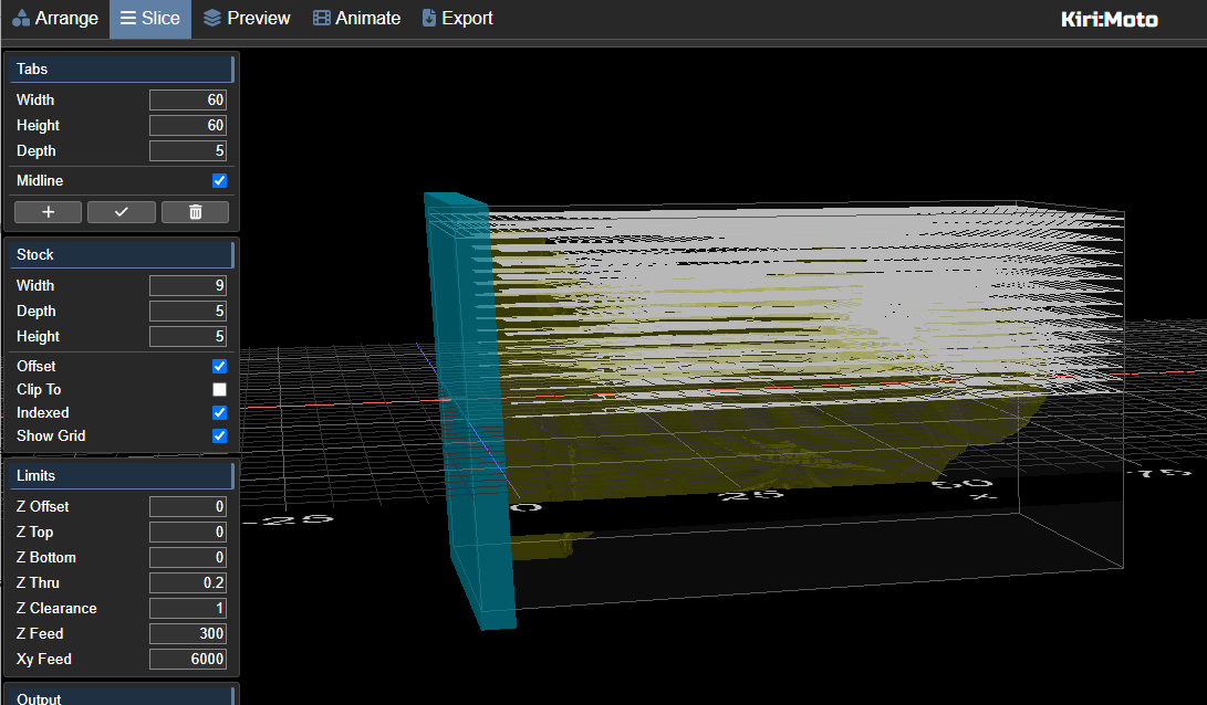

Hello, I’m new here, and I just started CNCing, I got a Makera Carvera Air, and I was trying Kiri:Moto for 3D objects as you have more controle that he Makera CAM software.

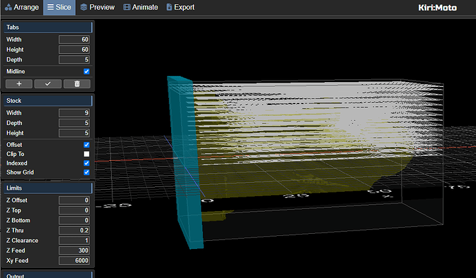

I think I found a bug, if I make oversized stock and I block off the part where my machine is going to hold the stock with a tab, it does work for the depth setting, but not for the height setting and is will run into the claws of my 4-axis lathe.
It seems that it’s not respecting the tab in height of indexed overstock, for the sides in depth field it’s keeping clear of the tab.
It’s only in indexed mode though, it works fine for non-indexed oversized stock.
I hope it’s an easy fix, doesn’t look too complicated to me ![]()
