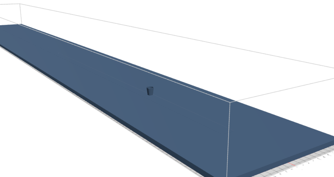

Hello, I am attempting to surface my spoilboard. Tried everything I could think of, @Stewart is the only solution I can come up with!
I would like it to start at 0,0 and shave off 1 mm. If this is not enough I will run it again.
I believe I am missing something basic.
I have hopefully attached the kmz file.
thank you.

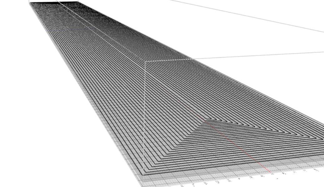

One of the ways you can surface your part is with a pocket operation, with a stock height of 1, and a z-offset of 1. I’ve attached a KMZ you can work from, and some screenshots here:
spoilboard fixed.kmz (70.8 KB)

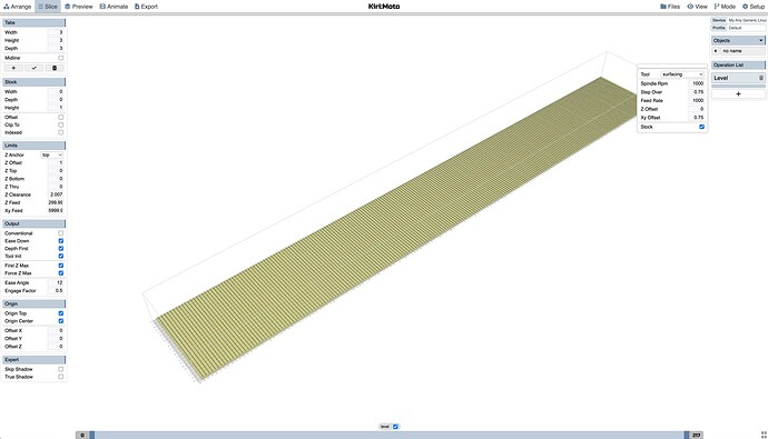

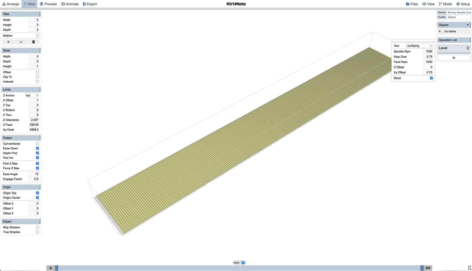

there is also the level operator which clears the top of any defined stock with or without a part present. .kmz attached
surfacing-with-level.kmz (581.8 KB)
