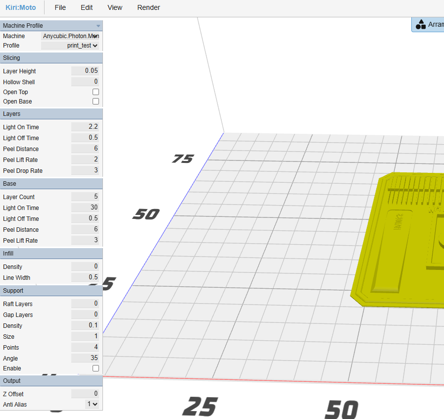

can you share your device / workspace settings?
Here is the settings.
I run the .pm3n file without resin, and I saw every layer’s exposure was about 30secs (all 28 layers).
I tried to view the .pm3n file in UVTools, I can see that layer height is no consistent in 0.05, some of them is even as thick as 0.3mm.
