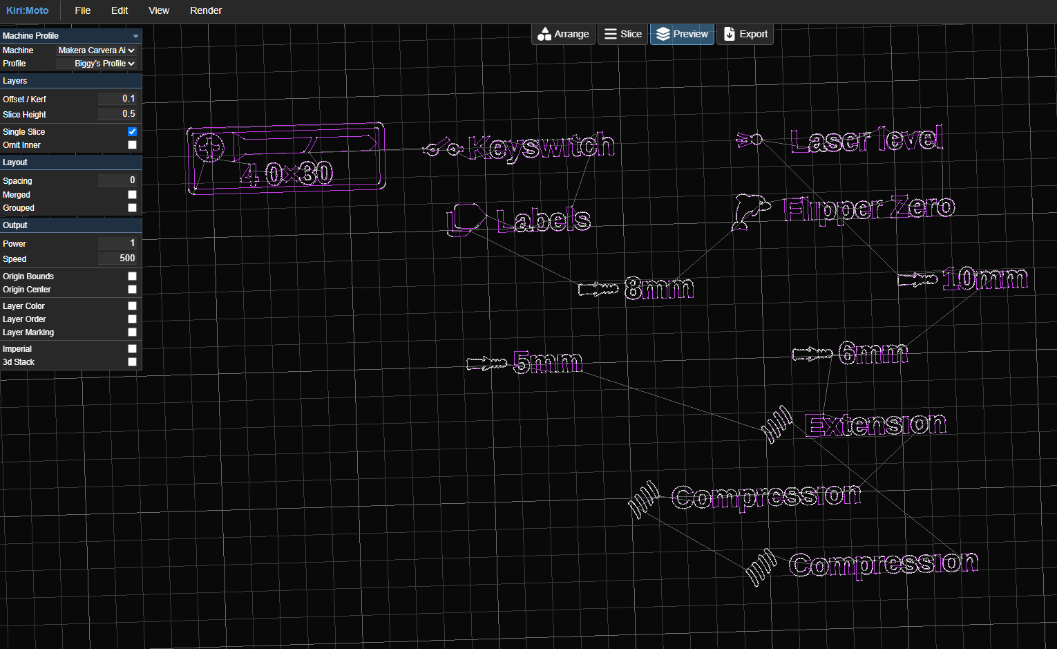

I’m using Kiri:Moto again in a way that’s not really intended but it’s incredibly usefull for me.

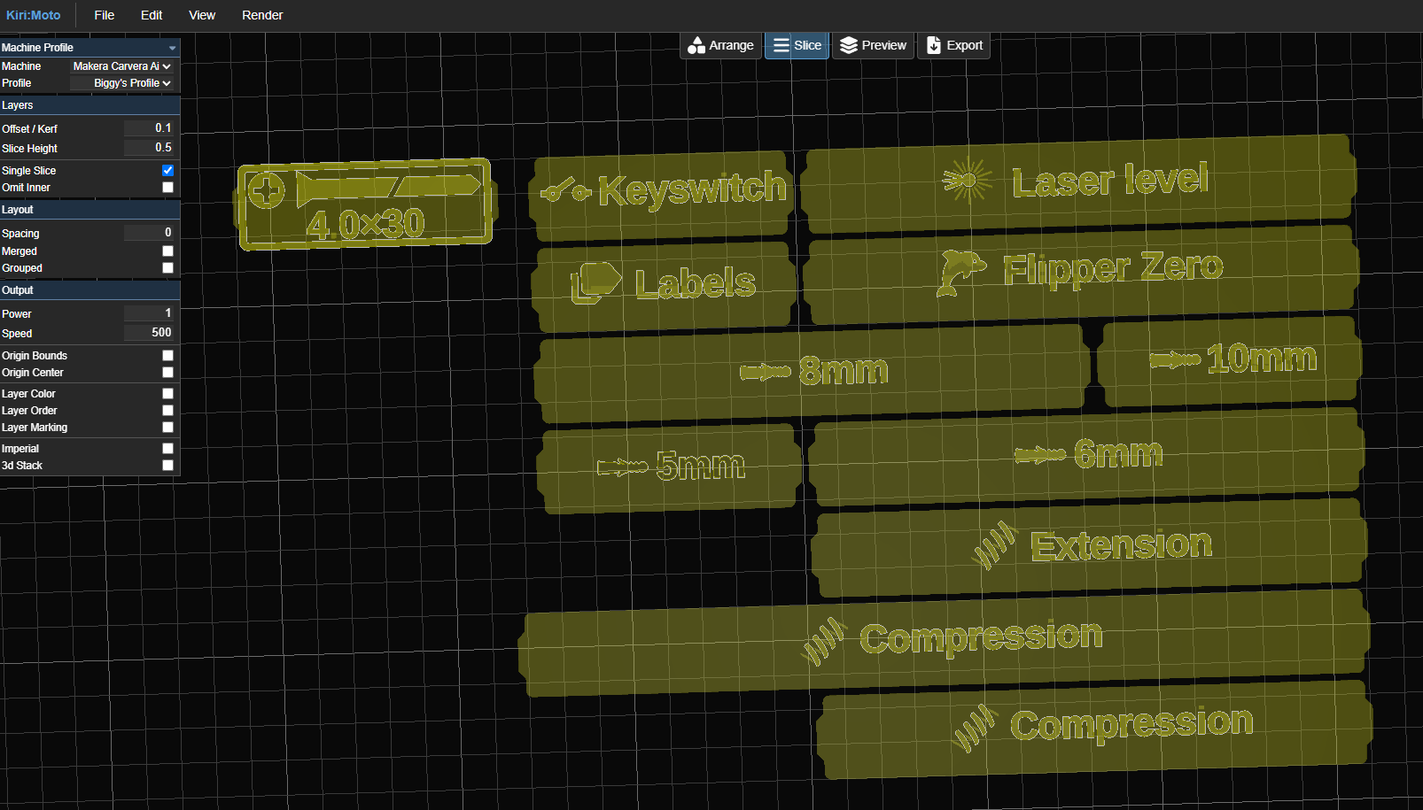

I want a vector file from a slice of some STL files so I used the laser module of Kiri:Moto, it does work fine in most cases, but for some parts it doesn’t:
Here you can see it skipts dots, and parts of icons (laser level icon, spring icons):
I’m exporting this as SVG so I can use the slice in other ways.
I’ve tried to fix the STLs in Creality Print also simplify, but that doesn’t change anything.. also I tried a kerf of 0, and in Preferences the slicer detail to 100 and heal mesh enabled.
I think it’s a bug in the trace-routine (as other small traces are working fine like the keyswitch icon), or maybe I’m doing somthing wrong. (I also tried the dev server, that’s where the screenshots are from)
