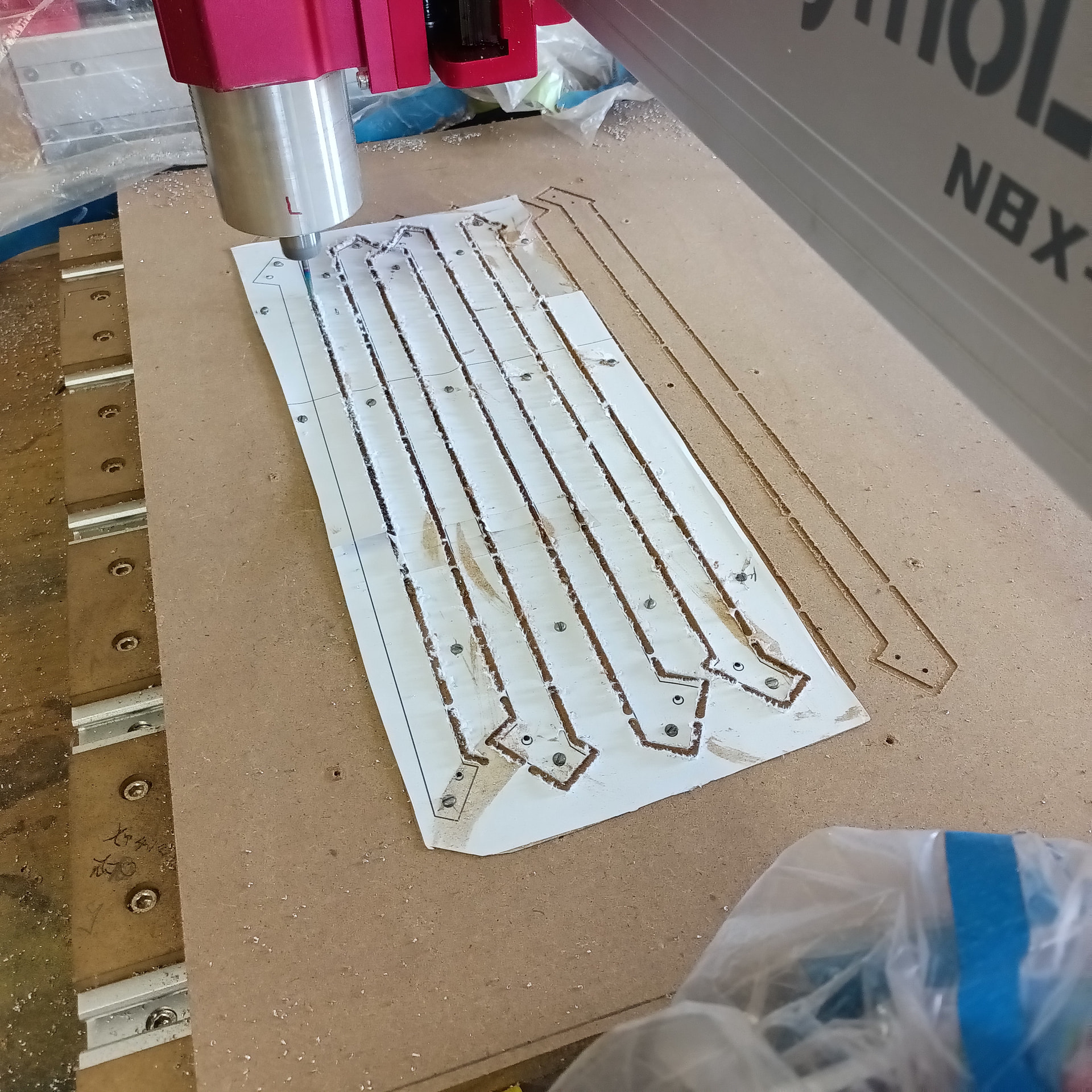

The xy feed between parts is not the input xy feed…also the travel is not at the safe height….almost hit a hold down screw.

This is not too obvious but the global limits are on the left hand side:
Z-Cleareance must be set so you do not hit any brackets. Z Feed and Xy Feed set the movement speed between parts
The z-clearance move fix is live on the dev server. Will investigate the XY feed issue. But it might have been caused by the fact that the move was diagonal down in Z which is treated as a cut instead of as a move.
yes that is what happened perhaps because the safe height was not working
looks good in preview….as regards no more z diagonal movement z….I did not check feed in the g code
