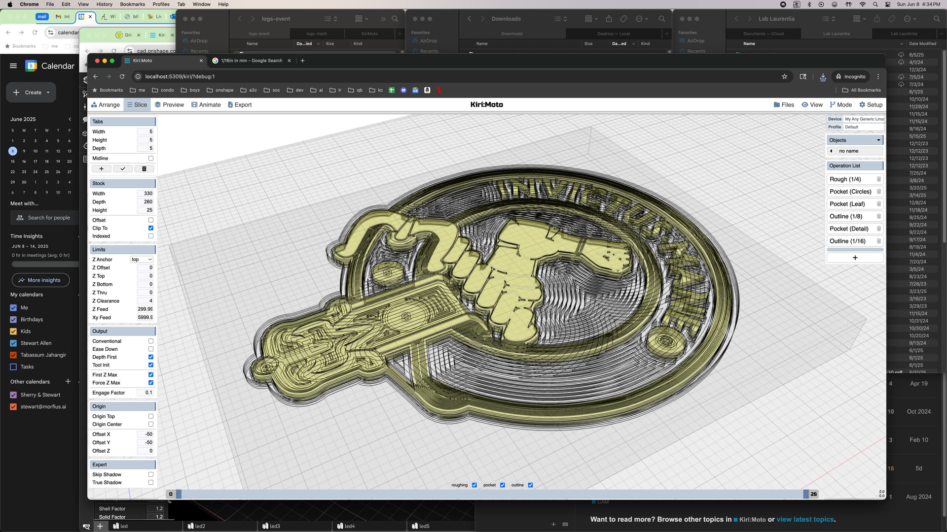

I hope someone can tell me what I have set incorrectly. Machine time is excessive because I am cutting air the majority of the time. My first roughing pass did as expected and removed the majority of material. second pass with a smaller bit spends most of the time cutting air where the first pass has already been. The third and final looks like it will again be cutting mostly air, this last pass is only required to clean out between the fingers as it is the bit that will fit.
slow invictus.kmz (902.4 KB)
I thought maybe I am transferring the files incorrectly. I moved three files across with only one of them active each time. The file is cutting beautifully but is wasting an awful lot of effort.
Thank you for suggestions.
David
