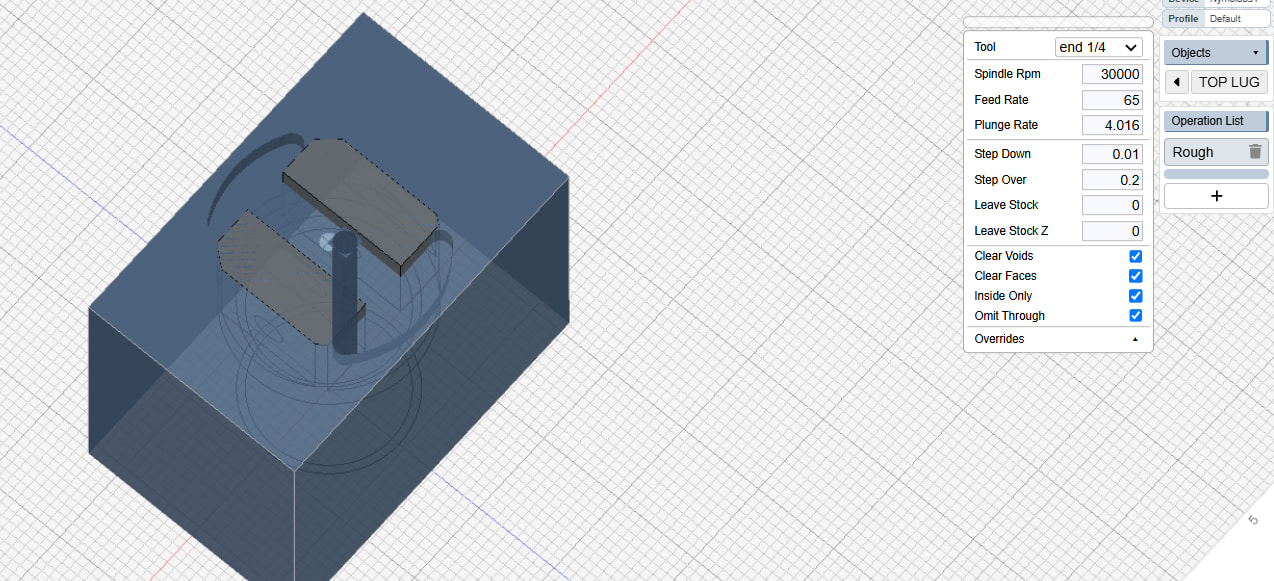

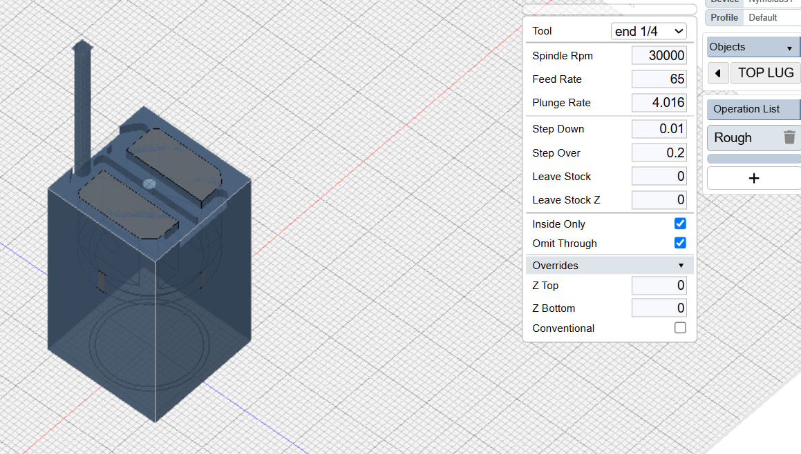

Problems Rough 4.5
missing overrides on rough 4.5
workspace_TOP_LUG4.4.kmz (357.9 KB)
workspace_TOP_LUG4.5.kmz (229.2 KB)
it’s there but hidden due to some overly clever code. there are two checkboxes that are mutually exclusive and somehow both are enabled so neither are showing. will push an update today that fixes it.
workspace_TOP_LUG (2).kmz (221.1 KB)
Not seeing any improvement but perhaps I misunderstand if it is fixed yet
I restarted my computer just in case it was a resident memory issue
it was a (new) units conversion bug. switching the workspace to mm fixed it. I also pushed a fix to the dev server. attached is a modified workspace using pocket instead. it cuts cleaner and only goes up and over once for each discrete area.

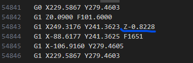

it looks like a rendering issue since the output gcode has the cutout. investigating now.
The Preview and Animate was all I looked at…..what beautiful features…..I no longer cut scrap tests
found and fixed and pushed a new build to the dev server
checked it with this file….it only went to the bottom of the .032 (-.82mm) part…..I had called out a step down of .040” in the Rough operation and in the limit section there is a z thru of .02”

can confirm it’s generating z’s below Z-thru on the dev server
yes, very helpful. still knee deep in muck. there are things like z-thru that are still on my todo list to re-implement with the new path code.
the .04 step down perhaps should have taken it to -1.016mm ? I think it is correct in 4.4.1 ….least wise I just cut the parts using that result and worked well and did cut below the bottom of the part into the spoil board
just checked 4.4.1 goes down to z-1.32 …..Not sure how that works out
oops that’s .82 and .5 mm or bottom of the sheet and .02 z-thru (.5mm) so the .04 step down is limited by the z thru…..duh
