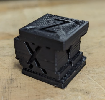

I allow the cube to finish, for the most part it prints fine, but occasionally it does that plunge and skip thing, finished print has shifts in both x and y axis.

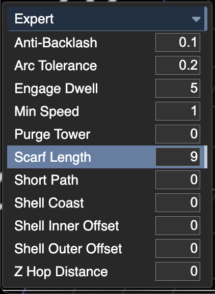

under the expert menu make sure scarf length is set to 0 and see if that persists. also, please use files --> export to produce a .kmz of your workspace and email it to me: sa at grid dot space … thanks
Great success.

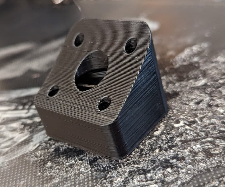

I got a chance to try this and it solved my issue. Scarf Length was set at 5, when changed to 0 the print completed without issue. There is a little bit of stringing on the inside, but easily cleaned up.

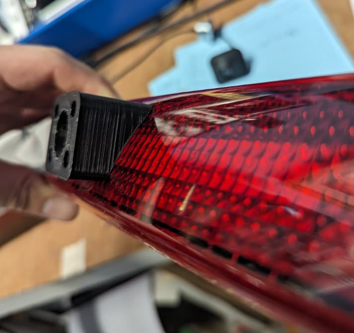

For anyone interested the part is a small reversing camera mount bracket. It is designed to fit the curve of a brake light on a transit van.
Thank you very much Stewart!
(I’ve made a donation to the cause)
The camera mount trial fit

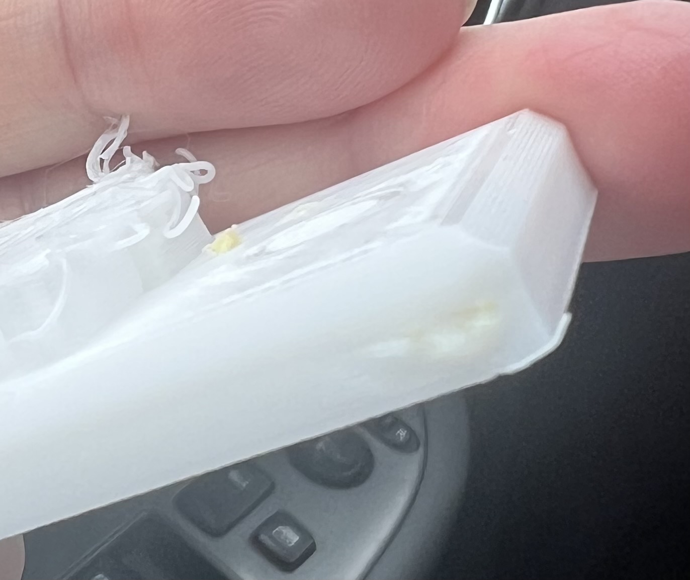

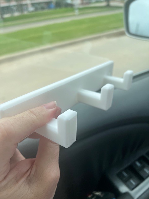

glad i searched a little bit. having the same issue on a couple of prints that i was trying. i have not only wasted filament but also spent what feels like so many hours trying to update the Z layers manually.
i am going to try this an reprint one of my prints that messed up. should know something in the next hour or so…..
thank you Stewart and mesolam for creating the post.

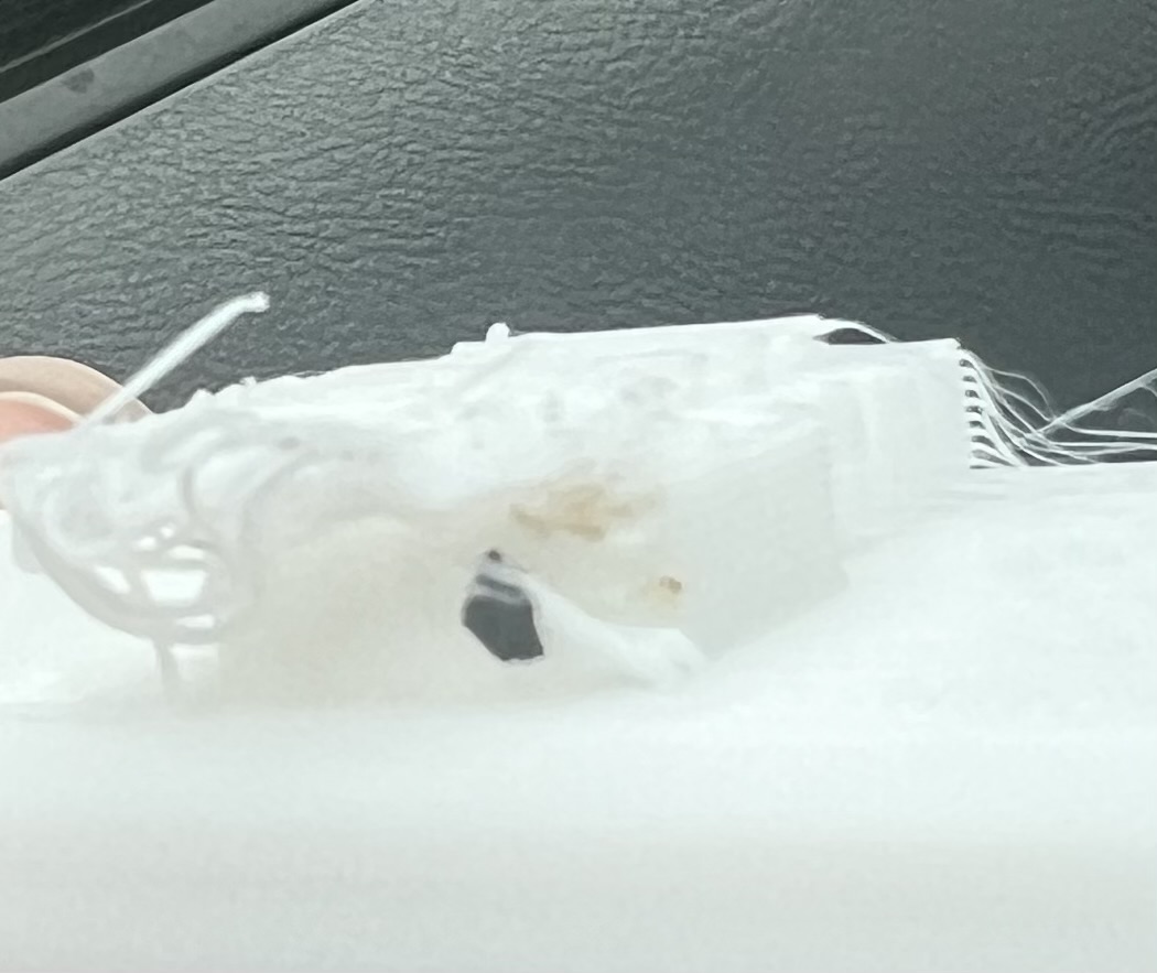

thank you!!! this adjustment worked! including a couple of bump/burn photos and then the finished product. the two photos for the white filament is a product by someone else. since the finished product came out so well i am printing a second one (its a towel holder).

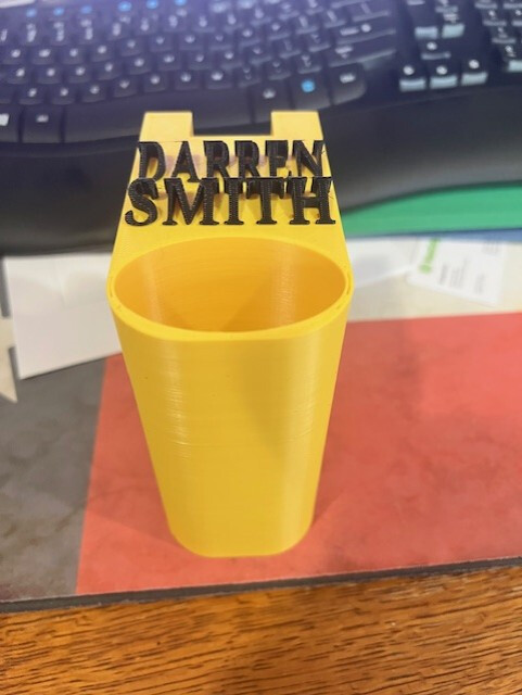

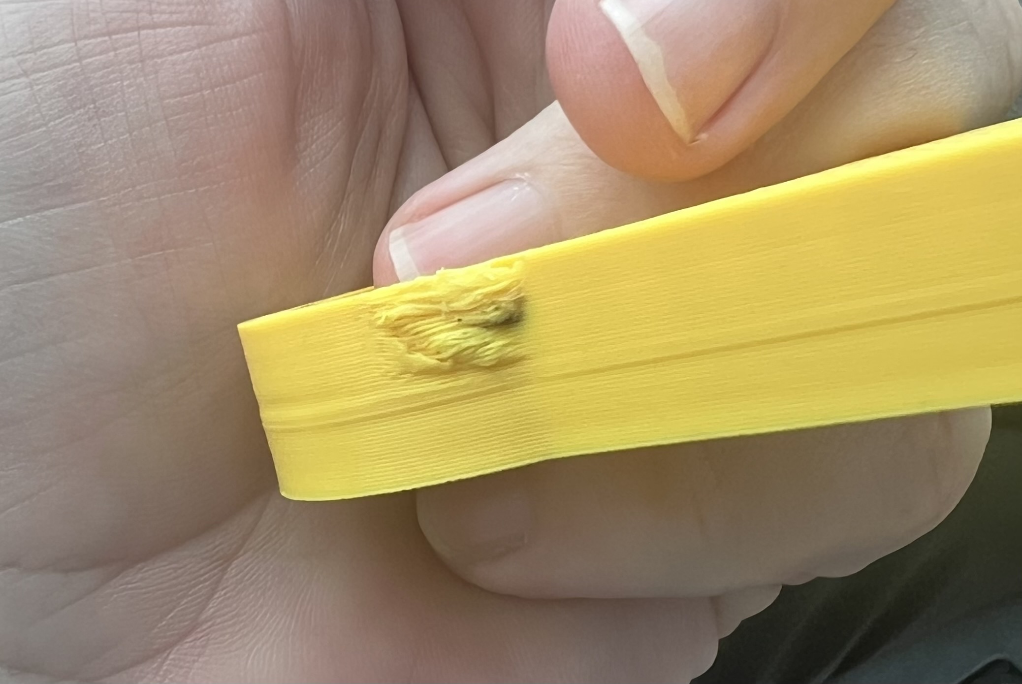

the yellow one is a custom file that i created and i really thought the issue was on my end. every different way that i adjusted or created did the same bump/burn, just in different places. that is the next on my list to try to reprint.
you can always drop your .kmz workspace here (file → export) for feedback

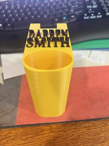

right now i am good. the yellow print that i have failed on many times, i am reprinting now on my printer. i recreated the gcode and moved the scarf code to 0. i typically cannot get past about 10-15 mm’s before i start having the issue (as shown in my photo). been printing for about 4 hours and i am not seeing any issues so far.
any chance you can explain what the scarf code does in simple terms? i tried to google it but could not quite understand what it did or was trying to do.

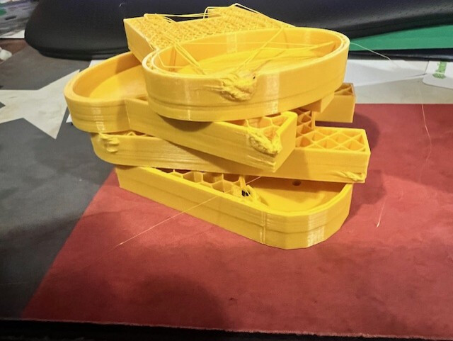

to say i have failed at printing this item is an understatement. here are 4 additional examples that had the same issue, some in multiple places in the print. and also attached is the finished product complete and beautiful!!!
