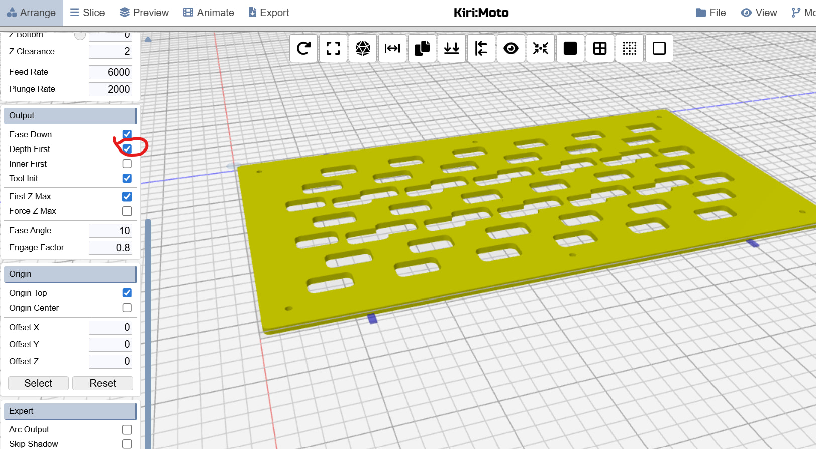

#1 What can I do to minimize the paths between the cutouts of my part? The spindle does not finish cutout by cutout even tough I checked “Depth First”.
