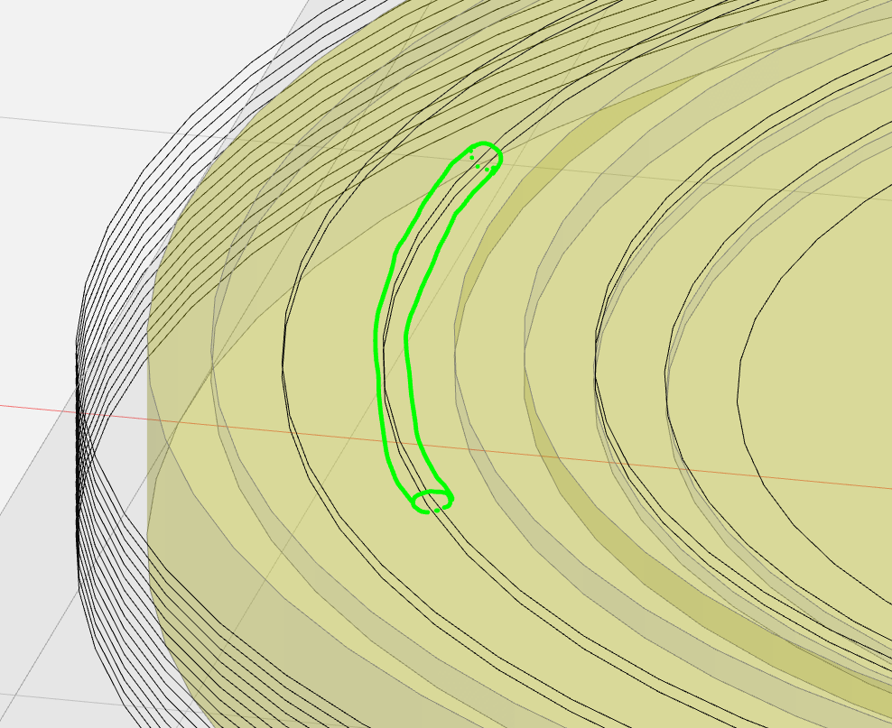

Here’s an outline op doing its expected thing:
The green-marked outlines step down an outward-facing interior face.

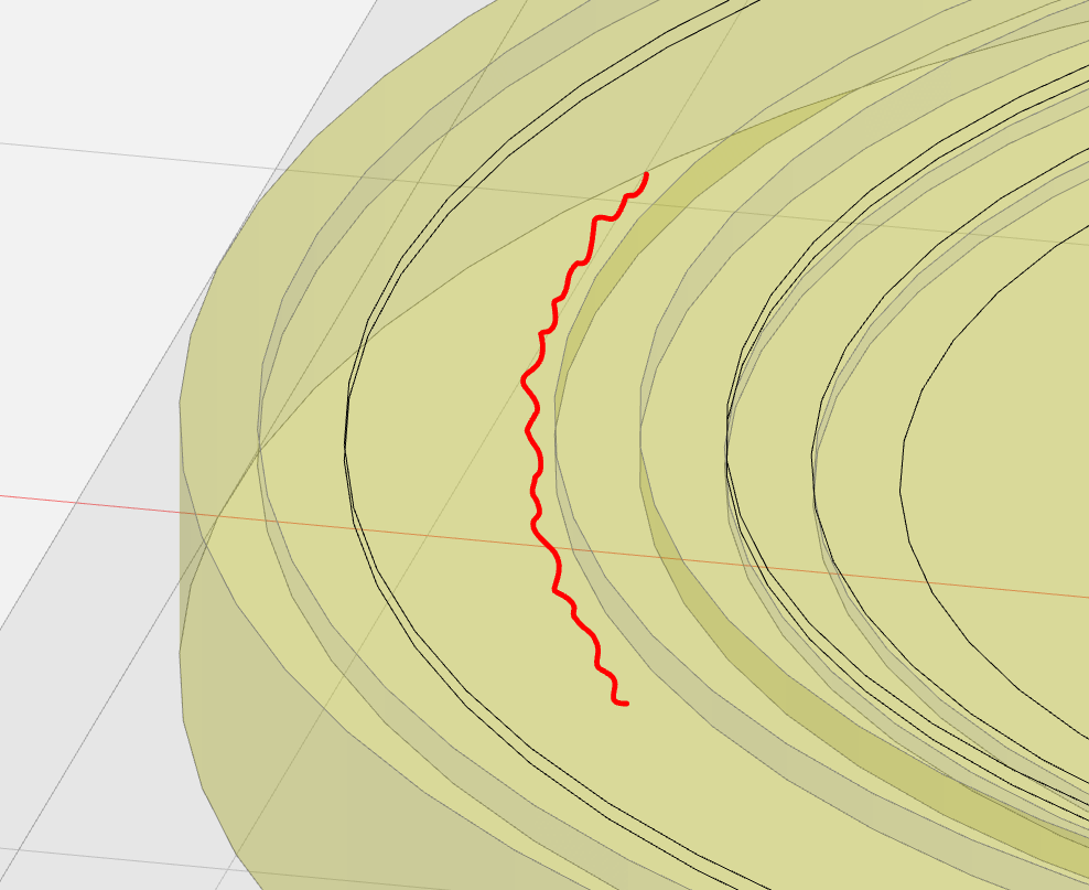

Here’s the same thing with Inside Only selected:
The red squiggle marks where there are no outlines around the outward facing interior face.
Here’s the workspace:
outline inside only.kmz (322.2 KB)
(edit: add topic tags)
yes, this appears to be a bug. thanks for the repro workspace
