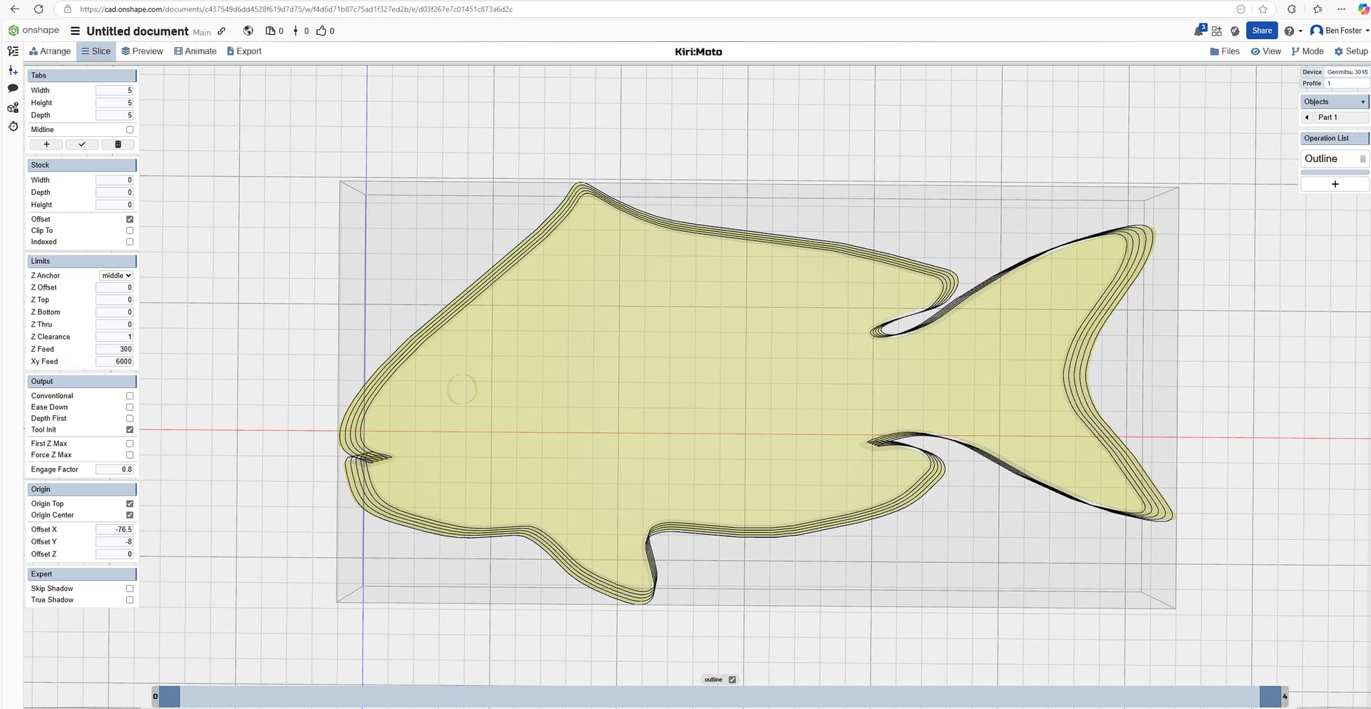

I’m trying to learn to use Kiri:Moto for cnc cutting. Here I have a fish Id like to try cutting out. I’d Like to cut out the eye and mouth with a small bit and outline the whole thing with a larger one.
I can pocket the eye and outline the overall shape very easily, but cant find a good way to cut out the mouth. Either I have to outline it all again with a smaller bit or contour the whole thing just to cut out a small part, but I would like a quicker solution if it exists instead of wasting all that time etc following the same paths. Hopefully someone knows some clever trick.
Thanks in advance
I can’t tell from the picture if the mouth has features other than being part of the outline of the object. Have you experimented with the trace operation and its options?
