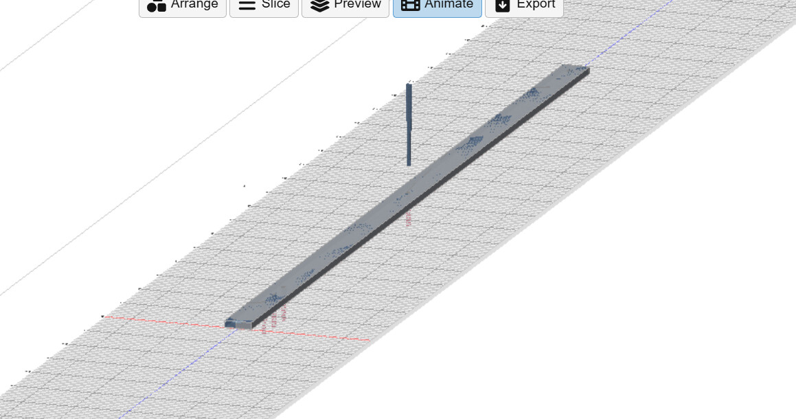

Onshape and cloud version animation different with same file
workspace_BR_8_Ba_front_cope (3).kmz (741.8 KB)

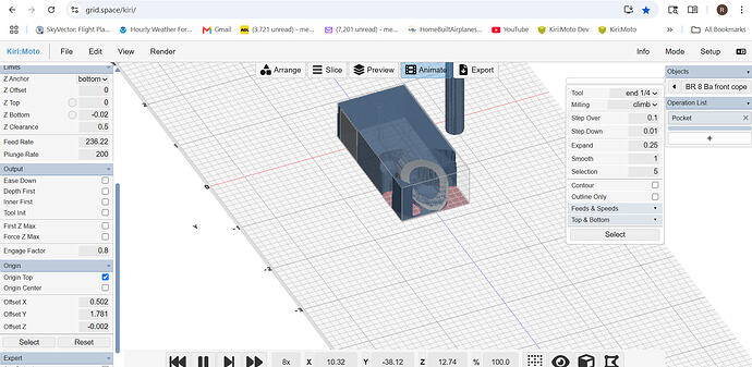

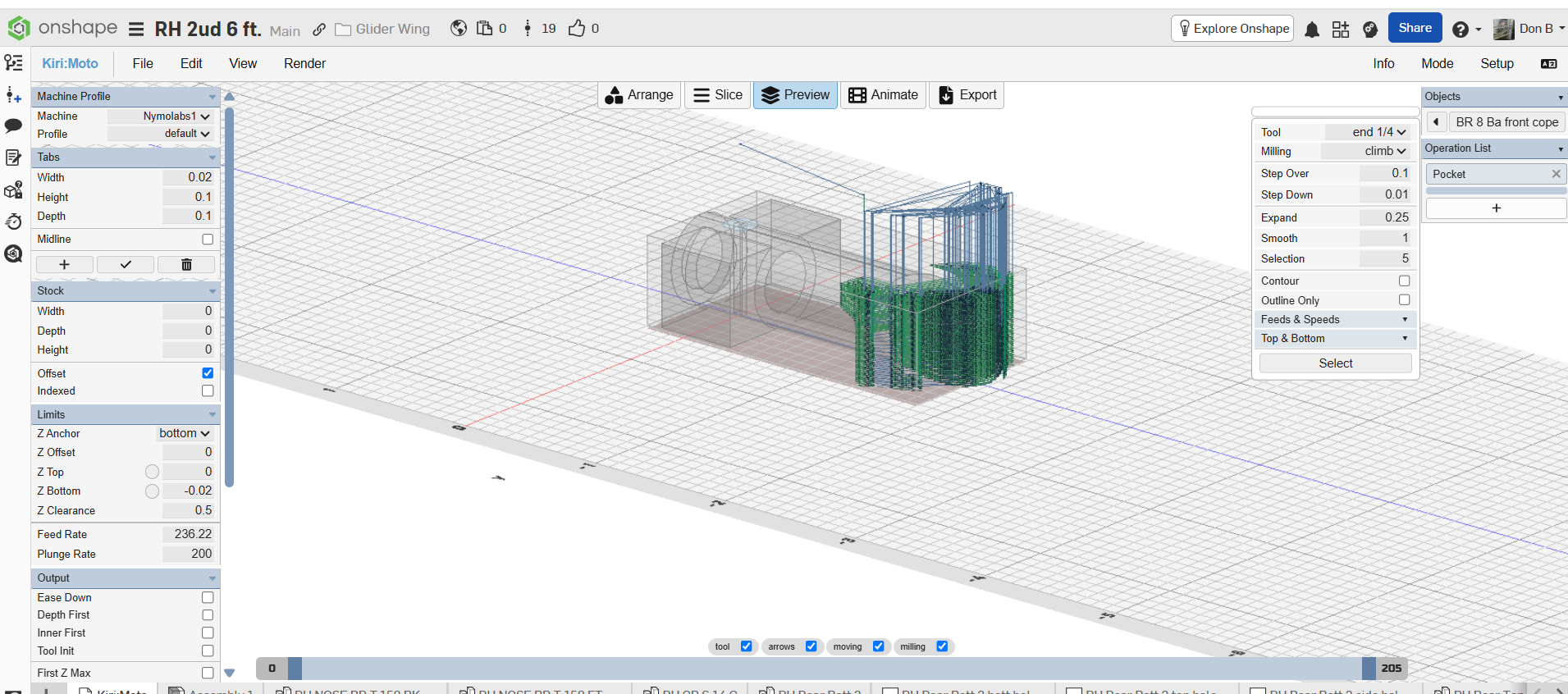

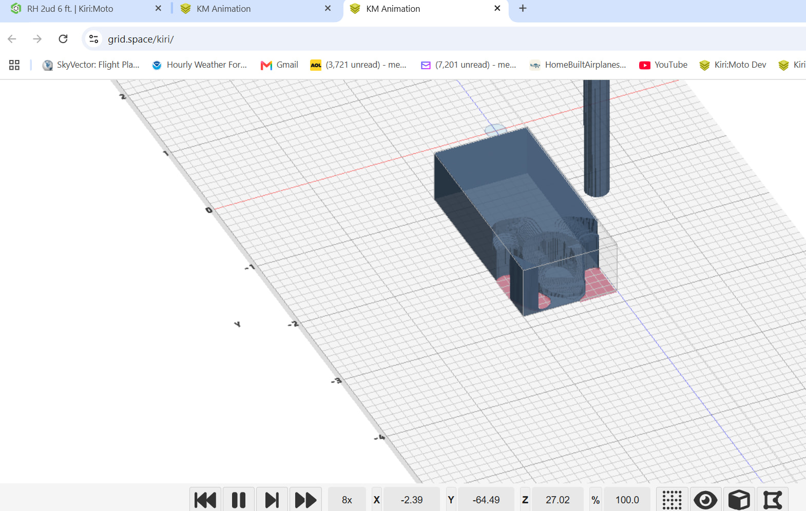

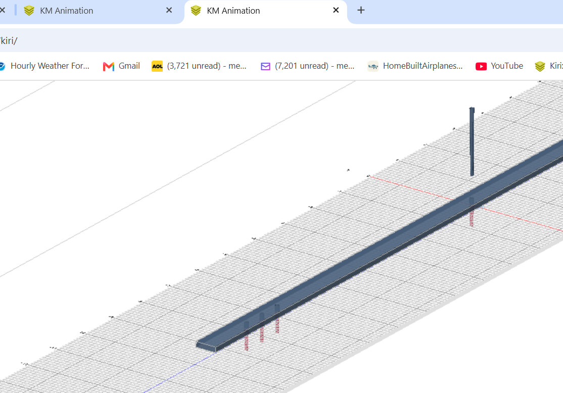

first two onshape…zero moved in animation and did not show cut correctly also when hit animation there are two tabs open …first one does not finish second one takes a long time.

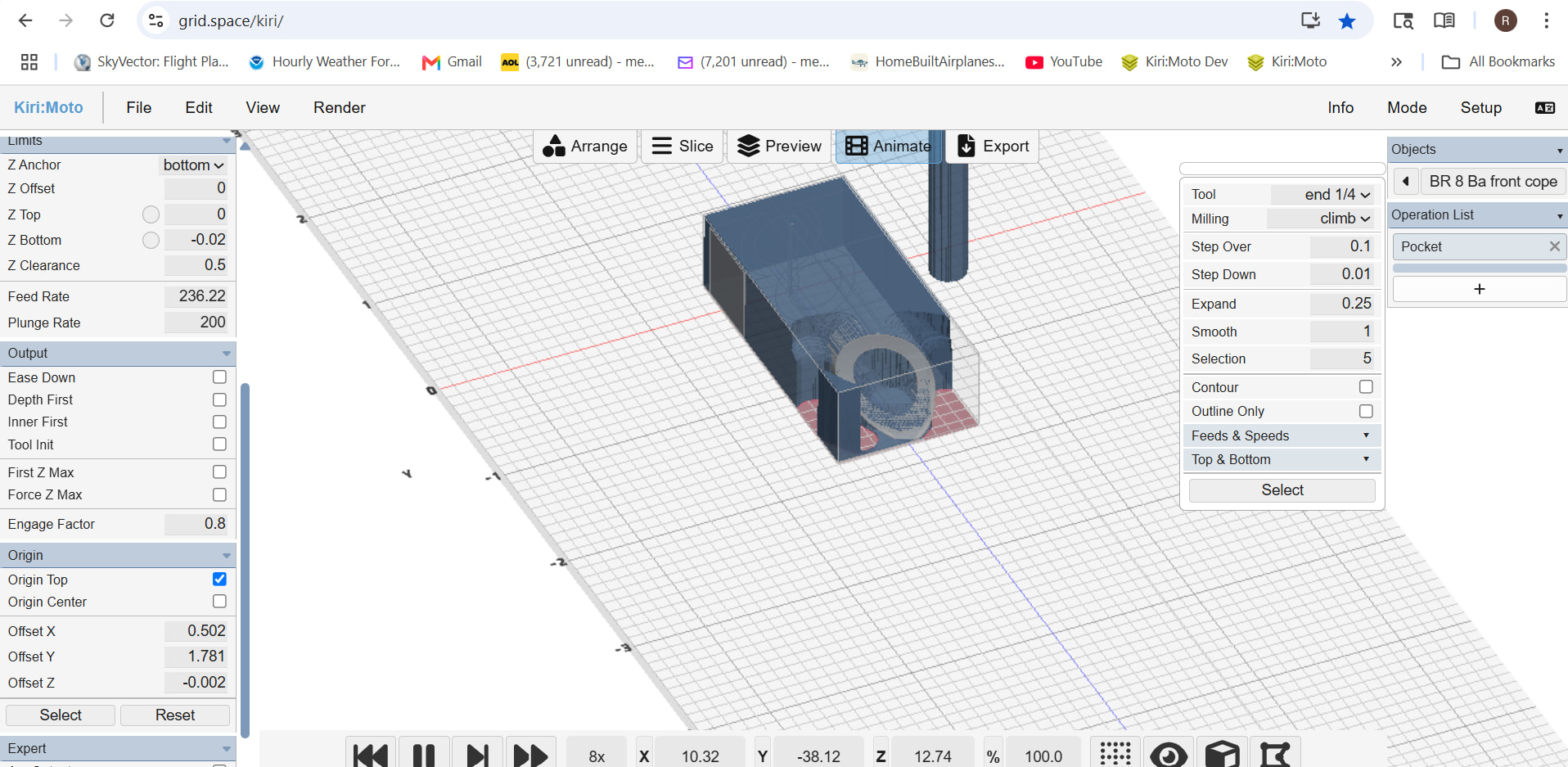

last one is animation of cloud version…looks good…all preferences are the same both versions

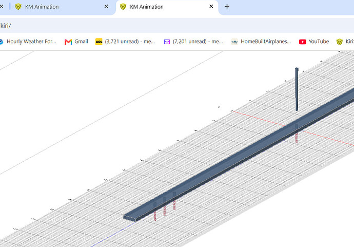

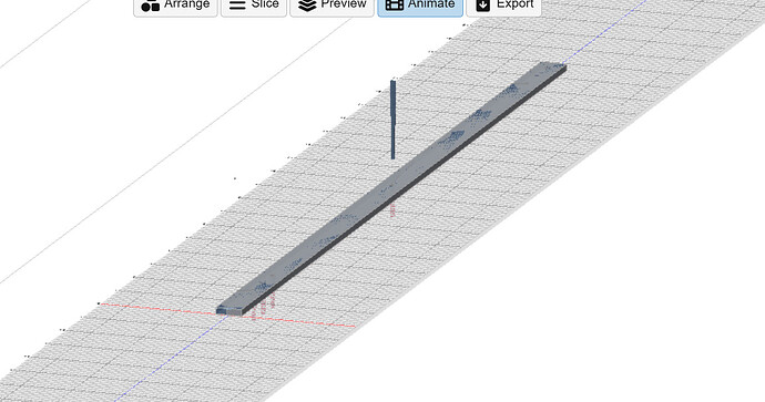

another example…first screen shot is from Onshape showing 2 tabs zero moved and part not shown correctly although the holes are put in the proper relative relation ship on the part…second is from the chrome version…it is a easy workaround but does add a step and several clicks…so far no problem with producing accurate parts …hopefully the software will continue to work with Onshape.
workspace_BR_9_Ta_bott_holes.kmz (589.5 KB)
chrome made a change a few months back (post in the forum somewhere) that prevents animations from running inside the Onshape iframe. so now I have to open a new iframe to run the animation when Kiri is in Onshape and that introduces new complexity. obviously there are still some issues with that.
it is an easy workaround to just save the workspace and open the online Kiri.
