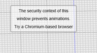

Getting this note in Onshape and I am using Chrome…and can not animate
workspace_Part_11.kmz (280.2 KB)
when I go to the online version it works…so bug in Onshape easy to handle by switching to Chrome online link
ver 4.2 is what chooser shows…
can you try shift + reload and see if it’s fixed? the chrome “origin trial” key that allows shared buffers in iframes expired.
I opened it again after overnight rest in Onshape and now it works no problem…fixed itself. I did not get a chance to try shift + reload…maybe closing down accomplished the same thing.
