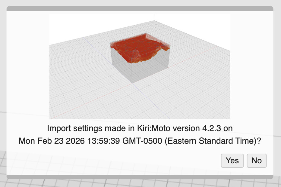

Hi, Stewart. Hope all is well. Just returned from sabbatical and went to use KM and the Langmuir MR-1 is no longer there. Any chance we can replace it? Here is a working workspace I just setup with a student from my offline version of KM. Thanks!
Welcome back, Phil!

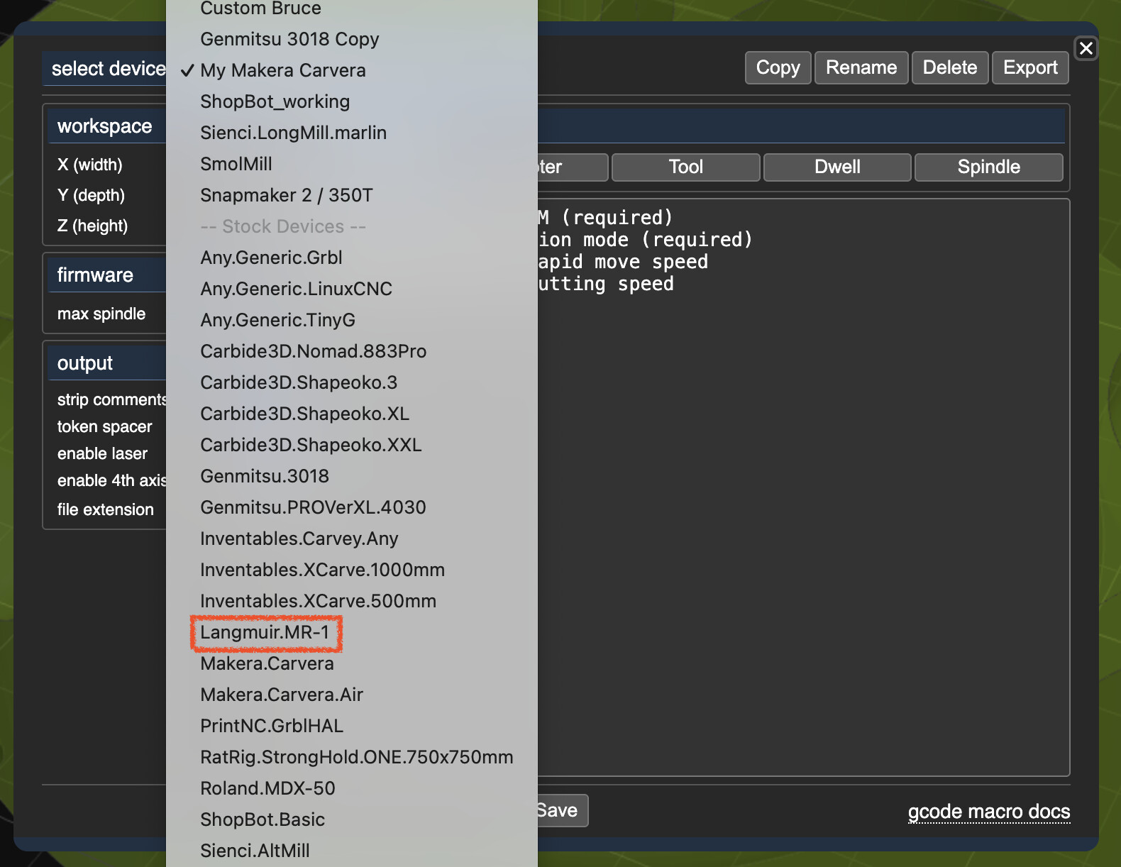

your workspace shows you’re on version 4.2.3 while the current version is 4.6.3 and does have the Langmuir MR-1
for an updated web version, go to the version chooser and upgrade
