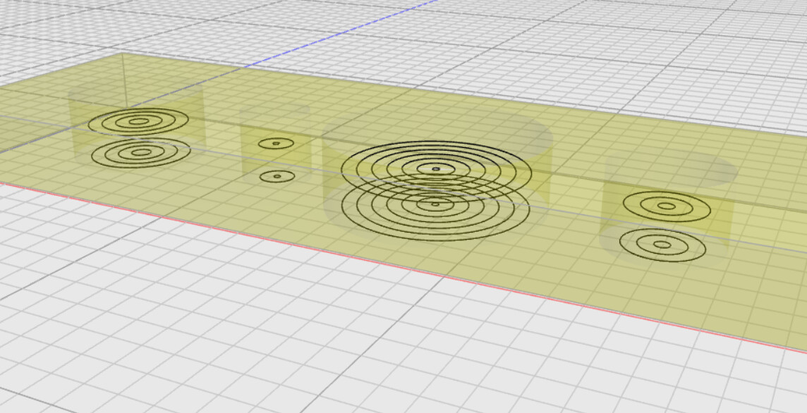

You can achieve this result with the trace (clear) operation.
hole clear test.kmz (371.2 KB)

Today I finally had a chance to run some test cuts using trace with clear. It was not a success. What trace does not take into account is that every other pass is either outside towards the center or inside towards the outer edge. When the final cut is outside towards in I have the central chunk moving around causing all kinds of havoc.
The boring cycle is always center towards the outside. Perhaps an option could be added to clear from the center?
note that the concept is to put many different sized through holes while using the same cutter.
I can add an option that always cuts inner to outer. the current algorithm moves to the next closest cut line and for thru holes, that can present an issue (if you’re clearing all material vs doing a cutout)

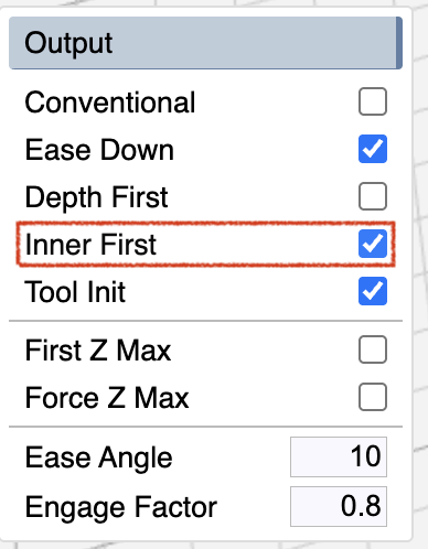

Is there any time frame to get the, “only inner to outer option?” I have some more work coming up where it would be handy and would like to use Kiri for it. I am not pushing just hoping its soon.
Thanks.
I pushed an update to the dev server for you to test.
https://dev.grid.space/kiri/
That looks perfect. I’ll try it out in the morning. I’ll post whatever the outcome.
The response of you and your whole team is nothing short of amazing.
I just got the opportunity to test it out, It works like a dream! Many thanks.
