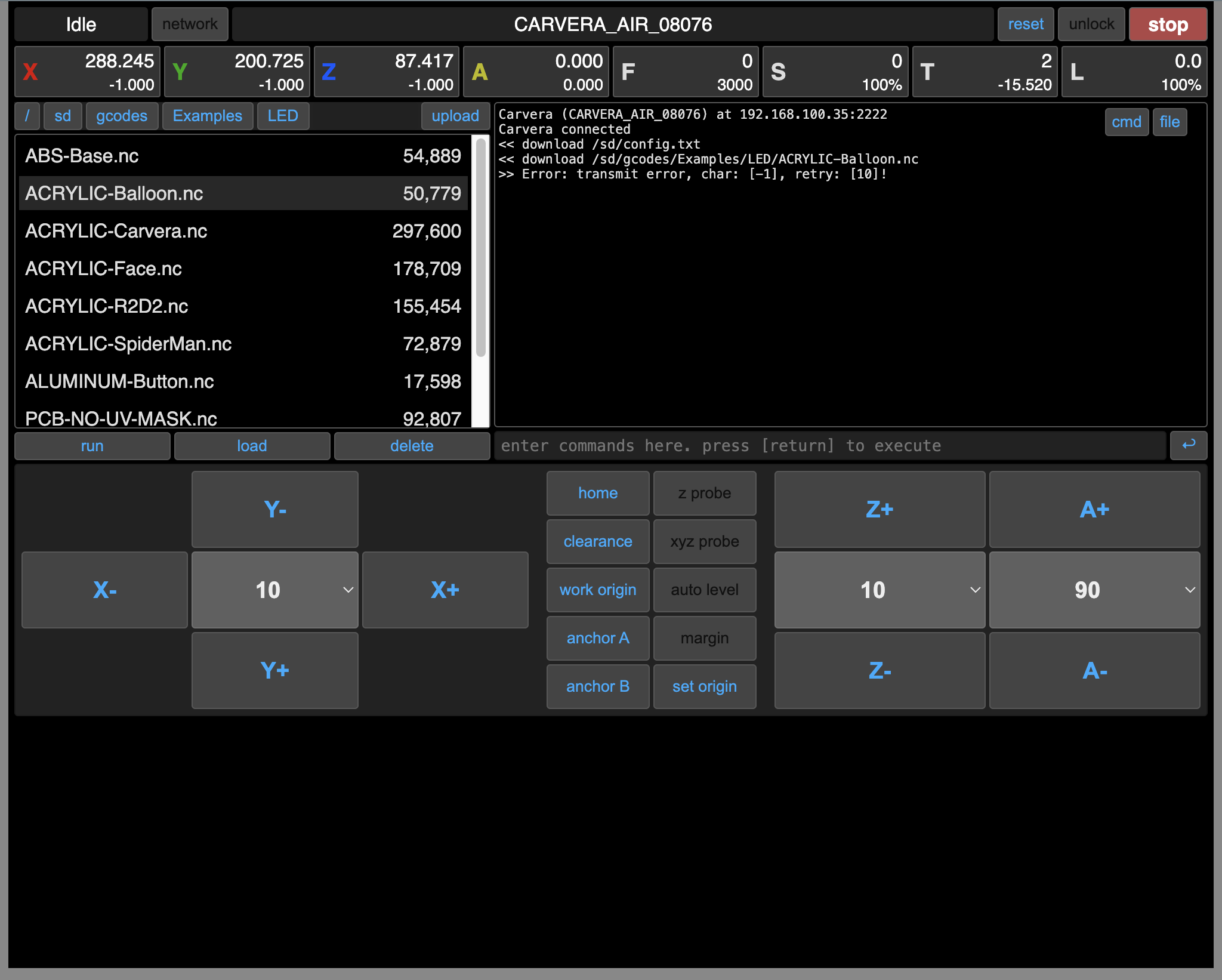

I can successfully connect to the Carvera Air, and I can successfully upload files, but I can’t load or delete any files, including loading.
When I attempt to load a file I get the following error:
Error: transmit error, char: [-1], retry: [10]!
When I attempt to delete a file, I get the following error:
Could not delete /sd/gcodes/…
Nothing happens after that.
I’m also not seeing a toolpath preview for any files, but I presume this is due to the loading error.
Any pointers please?

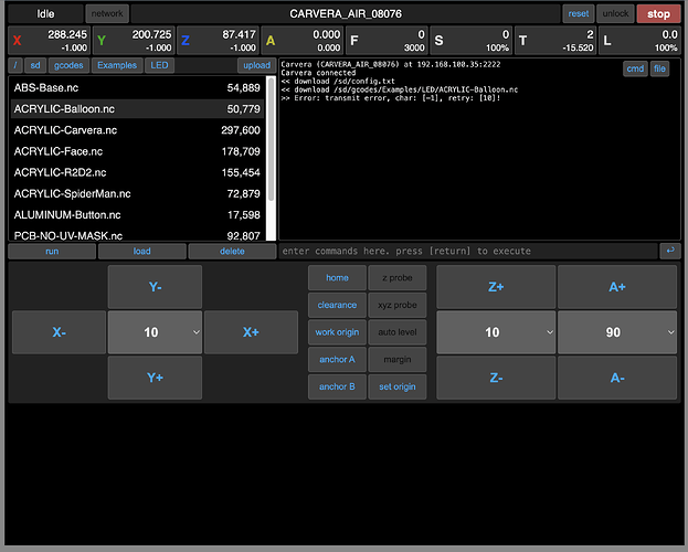

Screenshot of the error below:
Great to see this getting some use. I haven’t worked on it in over a year and the Carvera firmware may have progressed from what I was using at the time. I still have my Carvera, but it will be a couple of months before I have time for further development. i don’t have a lot to add other than ask if you have any ability to run / test from source.
