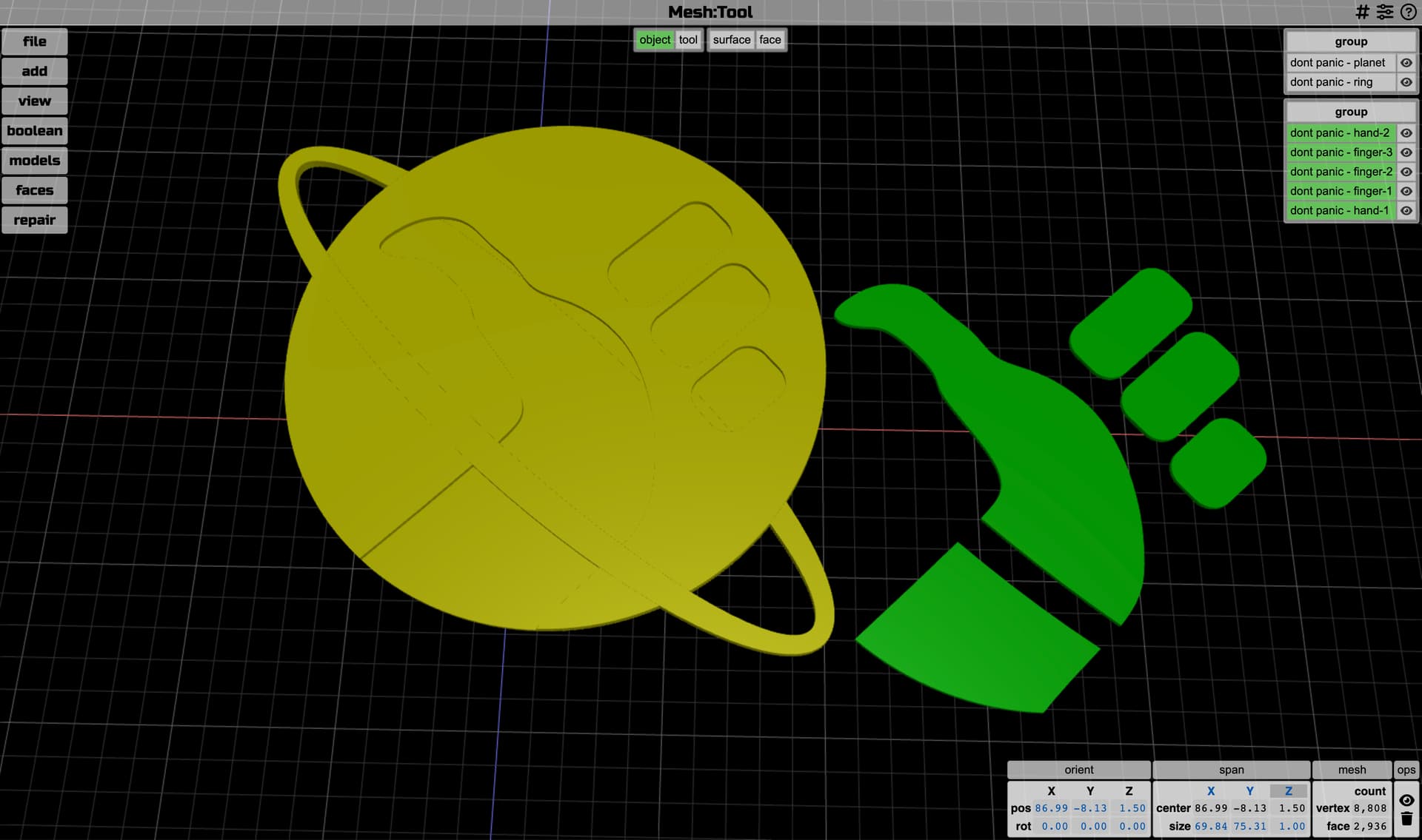

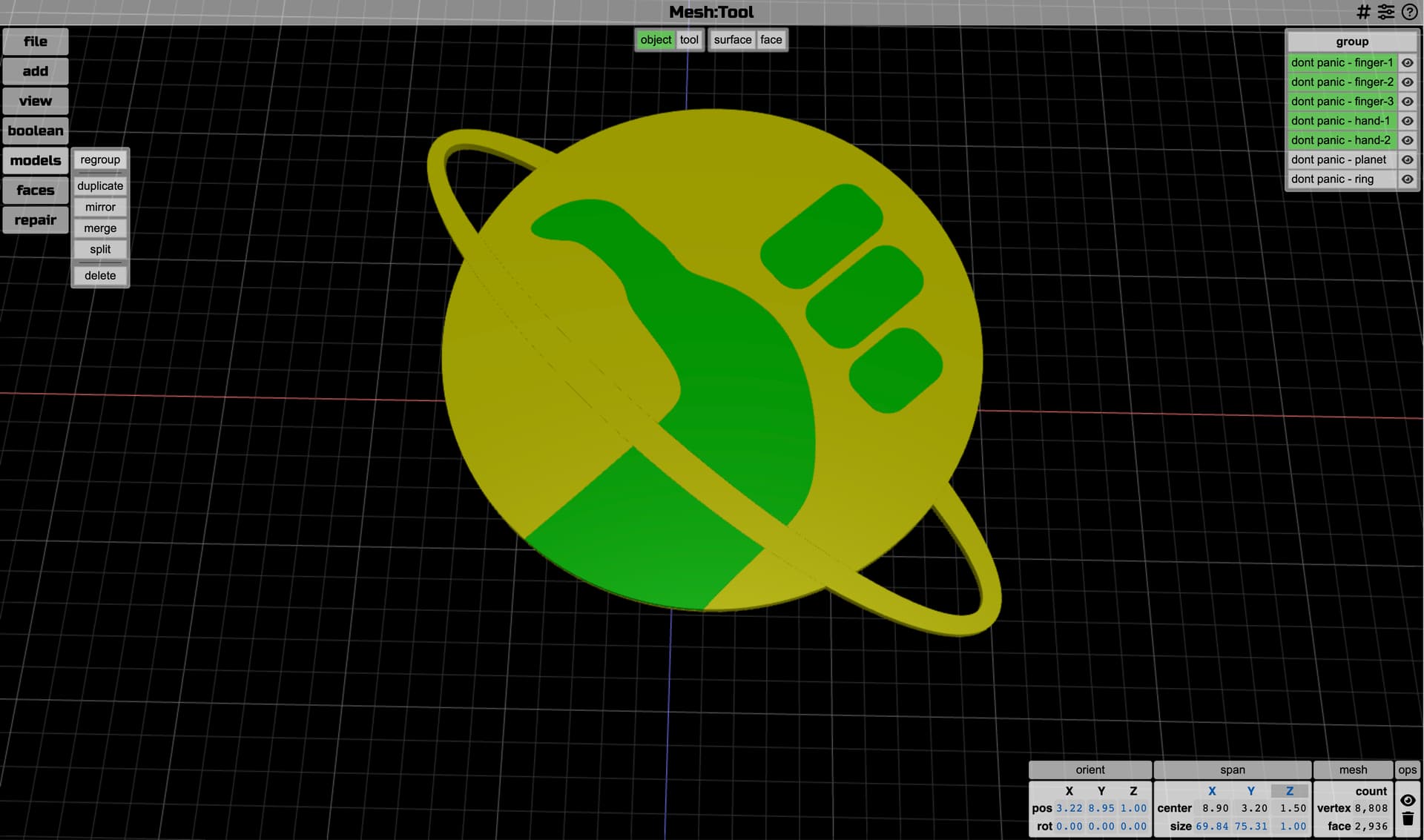

Can you be more specific? Is this related to Mesh:Tool or something else? If Mesh:Tool, you can use the right-menu to select parts of a multi-part object. Then Models → Regroup to make a separate group from them. Then shift+click+drag to move those parts.
