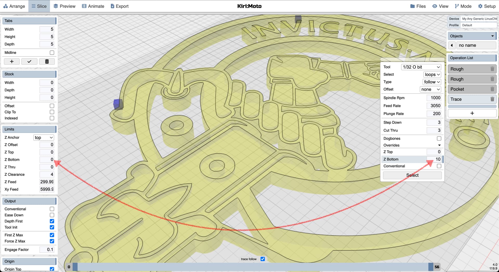

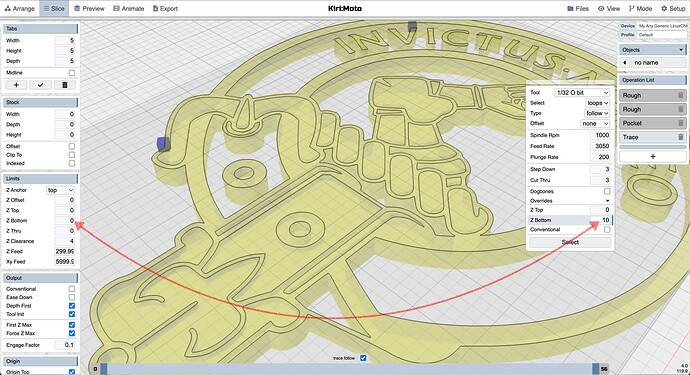

let me know if this does what you want. I’m using a trace op (ctrl + click the bottom of one feature selects all traces on the same Z) then using a z-bottom override in that operation instead of globally. if you use global z-bottom it will show you the limit plane, but it then applies to all ops. so it’s good for visualizing and testing then moving that value to the trace op overrides.
experiment with the global z bottom and this will make sense.
