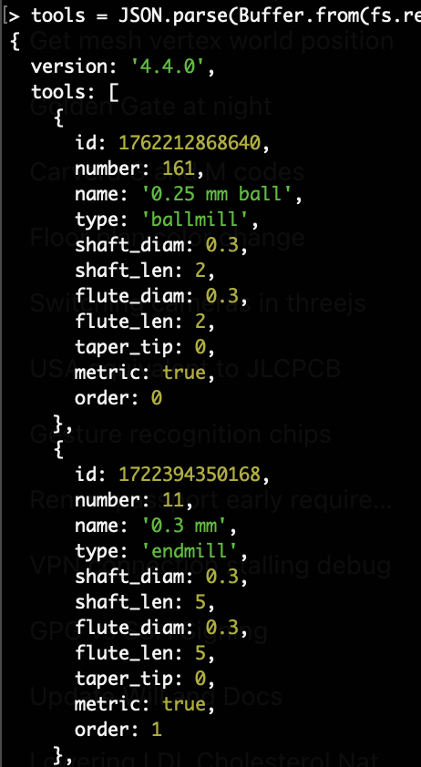

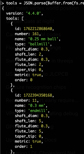

Hey, Mitch. When you use the tools export menu, it produces a .km file which is just a base64 encoded JSON string. You can parse it in node with a command like this:
let tools = JSON.parse(
    Buffer.from( fs.readFileSync(filename).toString(), 'base64')
then you can modify the resulting object/array and re-encode and re-import it in the same tool dialog.
Also you could use base64 and jq at the command line. :smiling_face:
