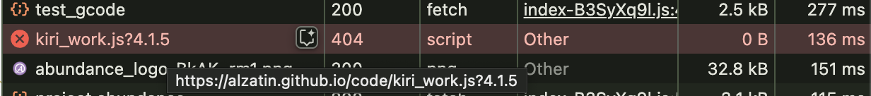

Ah yeah it must be new since I deployed it since for it to have the correct path for it would have to be “Abundance/code/kiri_work.js” but since the path is created in the engine.js I don’t have the chance to modify the path .

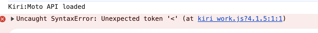

The script runs correctly on my local machine, but I get an unexpected token error, which might just refer to the HTML tags.
Maybe modifying the kiri_work file not to create a whole HTML doc, but to simply load the script would solve it? Not sure if you have any insight on this.
