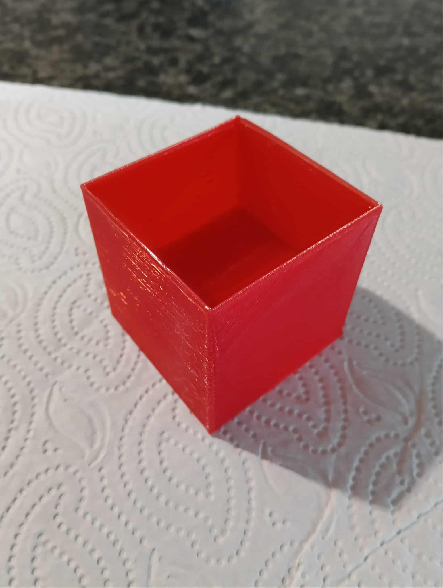

First attempt printing PETG with Kiri:moto vase mode. No leaks after 2 hours full of water.
Exactly what I was looking for. Tried with cura prior but due to the minimum wall width requirement of 2mm it was not workable.
