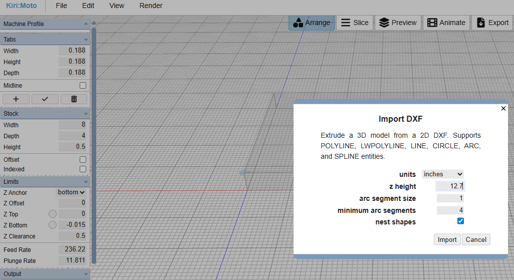

Hola Stewart! Thank you for that. Trying to convert my DXFs to STL, SVG or other has not worked well. I gave your add a try, not sure if I am missing something, the interface looks different than what I have been using the last few weeks, but it did not import as I thought or hoped it would. I am trying this for a CNC Router. I made a video this morning of an old cnc turret punch program I used for 22 years. I figure I could route out the same profiles, etc that I punched. https://www.youtube.com/watch?v=xacVE09eklY

I came back to this a few times and have figured out my errors while importing my DXF.
Your DXF import does function properly.

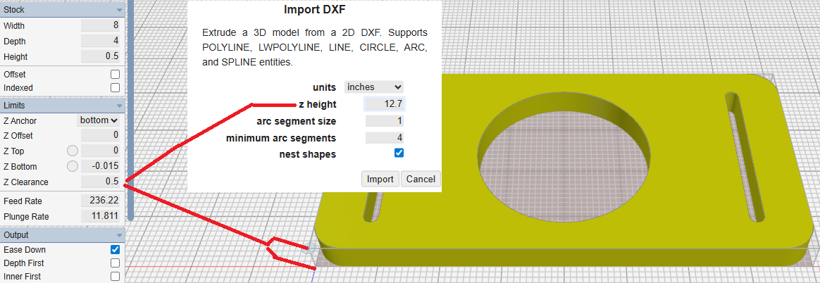

The only bug I have found is the Inch/MM, I have Preference set to Inch, I select Inch in the Import dialogue box dropdown box. The Z Height still requires manual conversion from MM to Inch.
thanks for the update. I’ll fix Z height import
