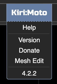

What version shows up under the middle menu?
Mine shows as 4.2.2. Do you think it could be that the students have an older version?

We’ve tried the suggested fix but it still seems to be an issue. I’ve checked the students’ version and they have 4.2.3 - which I also have. Strange that I never get the error but they do. It’s also intermittent - sometimes they can export and sometimes not.

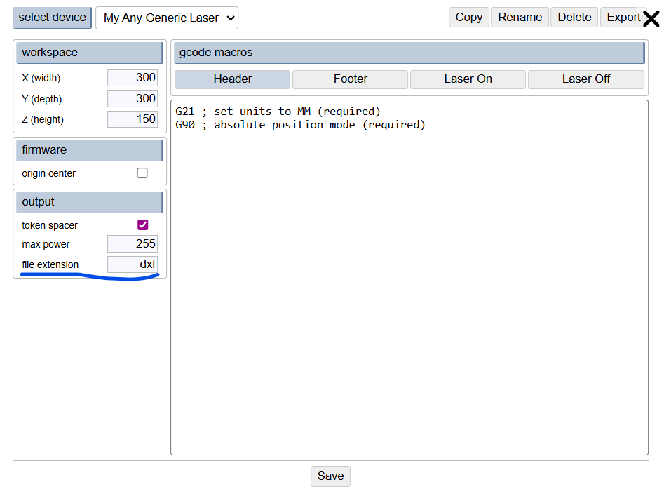

I’m 99% sure you’re getting that error because your machine file extension is not set.
in rel-4.2 kiri-run/worker.js, toUpperCase() is called on settings.device.gcodeFExt.

This should be handled better in the code, but as a temporary workaround, setting the file extention in the machine tab should solve the problem.
