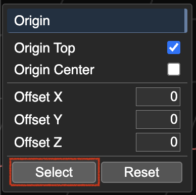

in 4.3 I’ve added a select option for origin that allows you to select the centers of holes as origin. is that what you’re asking?
I had no idea my dreams are coming true in the next version. I am still on 4.2.3 Thank you so much.
You can use the version switcher in the top/middle menu to try out 4.3 right now.
I apologize for being sttuborn about drag knife, but could that option be available on other modes as well (laser, drag, CNC), i switched over 4.3 but still cannot see the offset menus
Thanks in advance, and as @LeadDennis mentioned, your are makings our dreams come true :slight_smile:
the origin / offset menu is specific to the cnc mode at the moment. it’s not a quick port.
