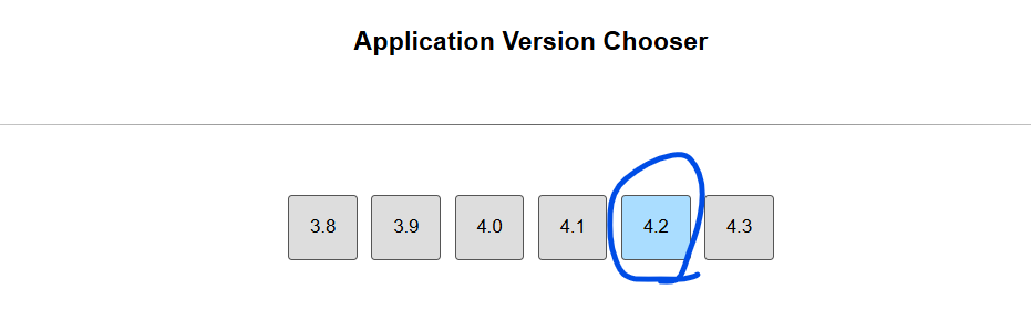

In the meantime, you can drop down to version 4.2 with the version chooser:
You will need to hold shift and click the reload the tab when you re-open Kiri:Moto, in order to clear the old version cache.
I was able to successfully generate a mesh with an image in v4.2 with a blur value of 5.
