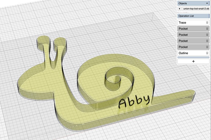

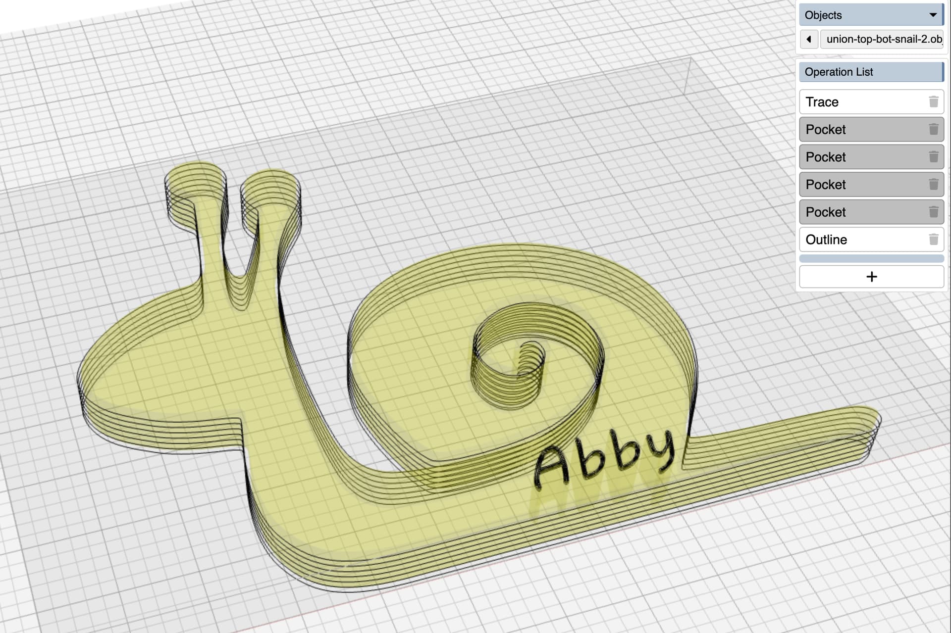

In the image below, I want to cut all the outside area, and then do the text “Abby” only following the lines with a depth of 2mm.
I don’t happen to find the combination. The Trace operation does not pick all the text lines, while the Outline operation includes part of the text to cut it out to the bottom.
This is the workspace:
workspace_snail_abby.kmz (848.8 KB)
BTW, which bit do you recommend for this text engraving? If I choose a tool that would work for a single pass, I don’t get any slice. With a very narrow bit, I get what you see in the workspace, emptying the inner space of closed letters like “b”.
Thank you for your help.

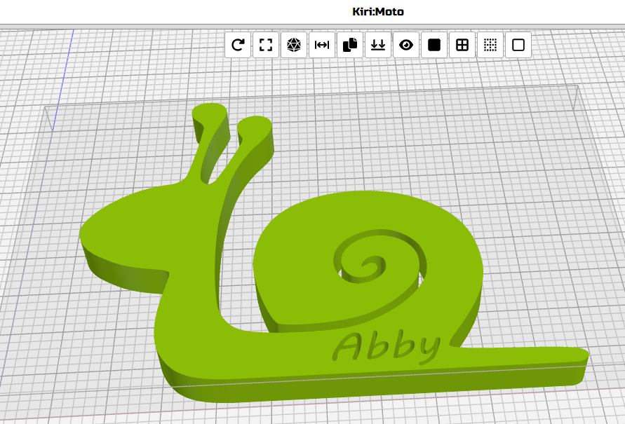

I noticed a few anomalies with the part. First, the inner letter areas were separate bodies. So I used Kiri’s Merge Object Meshes function to fix that. When they are separated like that Kiri treats them independently and can’t determine “inside / outside” for letters.
Then I noticed some anomalies with the mesh itself, so I exported it and loaded it into Kiri’s “Mesh:Tool” and added a bottom flat to the letters to provide a cleaner “surface” from which to select letters. This allows now using either trace or pocket to select the letter areas.
I’ve included the pocket ops (disabled) in the attached workspace. One anomaly with the current pocket operation is that it does not like multiple discrete pockets in one op. You can get odd behavior, so I separated the letters.
snail-abby-updated.kmz (1.5 MB)

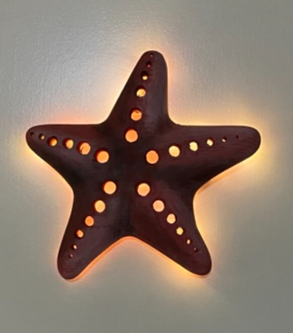

Here is a Sample of what I am doing manually until now that I got my first fights with the CNC:
This starfish has quite a few hours of manual sanding after cutting the silhouette:
And I am thinking about modeling in 3D and let the machine do the hardest work.

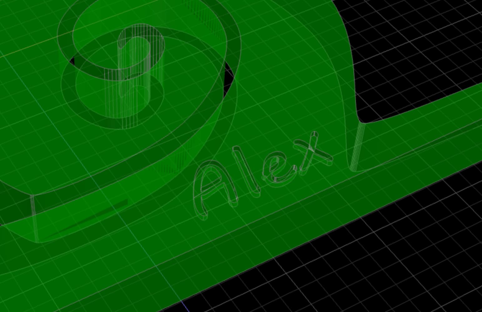

I extrude 18mm the snail (cargol.svg) and 5mm the text (Alex_text.svg). Then I resize the text group X size to 50% and relocate Z center to 17.52.
After this I move the text to the desired position where I can see the text intersects with the main part, and start the boolean subtraction (snail - A, snail - l, and snail - x). When trying snail - e I get the error.
If I am able to have the 3D model in Mesh, and I import to KM, which is the best operation to have the letters engraved as shown on the 3D model? I don’t get the Trace operation to dig to the bottom of the letters, that would be located at 16mm from bottom of the stock.

There are some anomalies in your mesh that I struggle to explain. Did you bring it straight out of Mesh:Tool into Kiri? Anyway, I took it back into Mesh:Tool and then re-triangulated and flattened the bottom of the letters. Then I brought it back into Kiri and opted to use the Pocket operation instead of Trace. And moved the lettering first since it seems to make sense to do the cutout of the snail last.
workspace-snail-alex-remesh-flat.kmz (850.2 KB)
