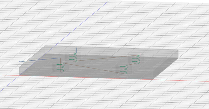

When helical is in Reverse mode the path takes the end mill through the stock material instead of going to a save Z. Works fine in non-reverse mode. Only happens in 4.5, 4.4 is fine.

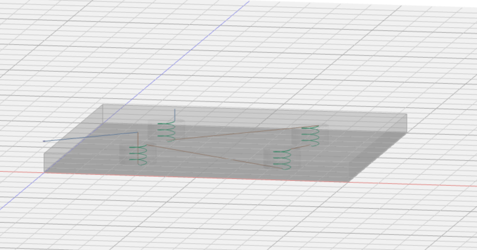

on it. thanks for providing a workspace.
this is fixed on the dev server along with your other bug report.
Thank you, it’s working!
