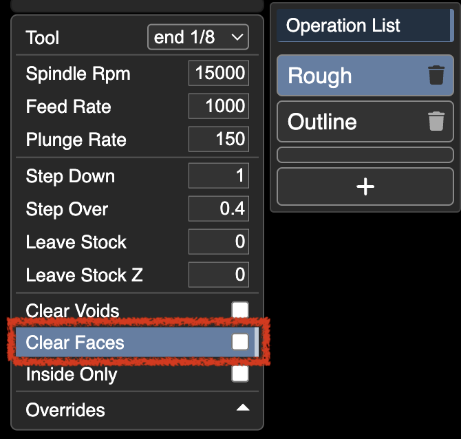

When trying to cut holes in a polycarb plate, the toolpath started following the face of the plate without cutting anything. We’re using the rough operation with clear faces off, and the stock height is correct. We checked the CAM preview and it goes through the entire face as well as the holes (it said it would take 26 minutes). The inputs were the same as we usually use and we tried it on two computers with multiple different parts. We have never had this problem previously.

did you enable clear faces or change the Z anchor under limits?
We did not check clear faces. Changing the Z anchor to “top” seems to have solved the problem? Not sure why this is, since we haven’t changed any settings since last time we used Kiri:Moto.
