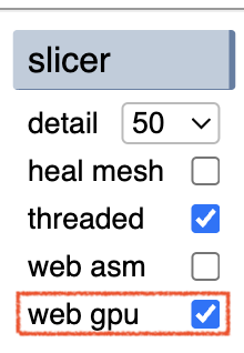

I’m tracking down a bug in the CPU based contouring code that seems to cause this. In the meantime, please try enabling GPU acceleration since that uses a new code path for contouring that doesn’t have this issue.
Hi Stewart,
Thank you very much for the information. It solved my problem. :folded_hands:
